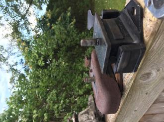

My van would jerk and shake when I put it in reverse, it was quit embarrassing and I thought the whole thing was falling apart. But I was told to Chang my motor mounts, I was sceptic, But I changed the two engine mounts anyway I thought it could hurt, mounts are cheap and it only took a few hours to change them. It Worked! No more shaking in reverse and a slightly smother ride.

Traveling Amman
Attachment 8132
I've been wanting to replace my motor mounts! Did you need to remove anything or disconnect the fuel filter? and did you put the jack underneath the bell housing flange?

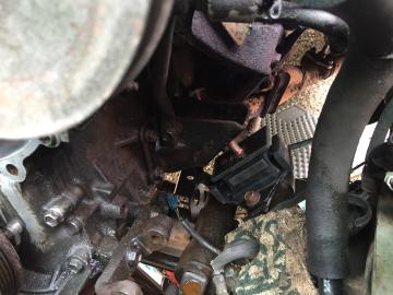

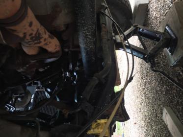

Attachment 8901Attachment 8902
i used the OEM jack and a 2x3 pice of wood that fit tight under the oil pan, jacked it up just a little then unbolt the engine mount and jack some more, slide out old mount. Now the new mount will be much thicker and the jack will be have to be up as far as it will go to get the new mount in. I did one side at a time, but it helps to have both mounts lose as you jack up. I also painted the Metal brackets red, that fit over the motor mounts.
When I did the motor mounts, I also did my water pump, thermostat, alternator, and coolant flush. So I had already removed all these parts and had easy access to the engine mounts. But you might not have to go as far as I did removing those parts. My van is 4wd, there is not much room down there with the front axle in the way.
