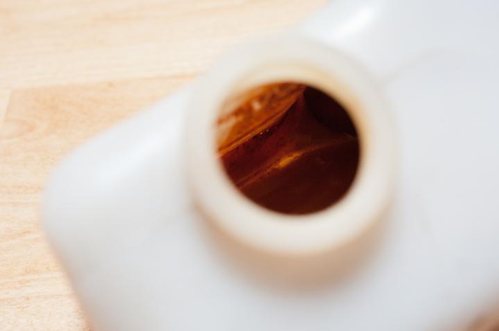

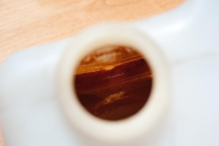

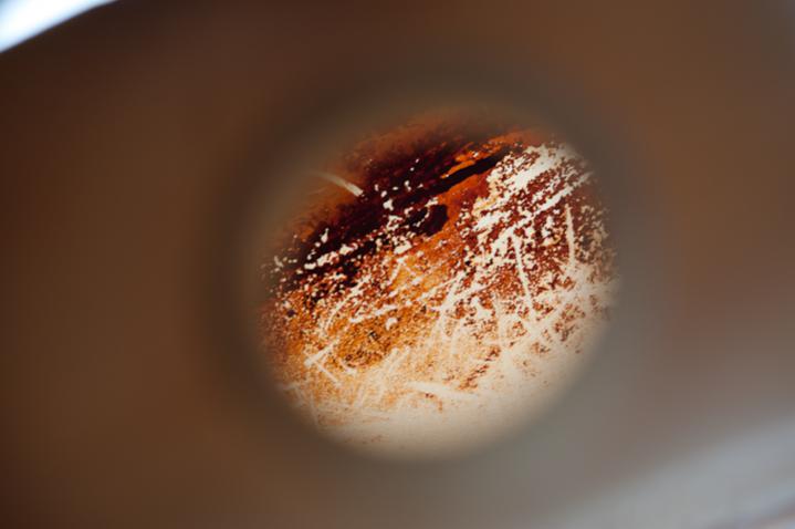

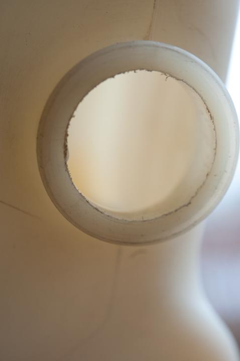

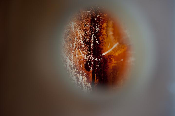

Today, I thought I'd share my experience on how to clean a dirty reservoir tank. After replacing worn coolant hoses, and completing a thorough cooling system flush, it was on my list to find a way to clean the recovery tank. The previous owner had left the tank looking pretty rough. Neglect had left a thick coat of rust/grime along the inner walls, entering the possibility of tainting fresh coolant. (That, and it looks gross.)
Attachment 570Attachment 567Attachment 571Attachment 568Attachment 569
I'd tried conventional cleaners, and brushes, with varying degrees of success. Most solutions were like trying to clean a carpet with a garden hose, they just didn't work. Brushes were limited in that they couldn't reach into the tank effectively. I needed an abrasive material, that wasn't so harsh that it could damage the coolant level float inside the tank. I had heard of using coffee grinds -- but I had a item on hand that could work better: Kitty Litter.
Attachment 572Attachment 573
Meet Homer (or 'SlugLoaf' as I affectionately call her.) Without her, I wouldn't of had an ample supply of material to use. The process is simple really. Pour a 1/2 cup of litter into the tank, and fill the tank halfway with water. This particular litter was designed to be flushed down the toilet, but as long as you have more water than litter, clumping/hardening shouldn't be an issue.

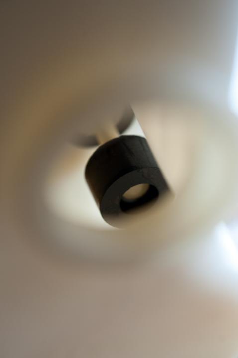

Once its inside the tank, replace the cap and shake vigorously for a few minutes. Dump the contents out, and rinse. Repeat as necessary until clean. If you find you have really stubborn deposits, soak the tank in CLR for an hour (or over night) before using the litter. As you can see the tank is now clean, and the float is undamaged. Hopefully this'll help some of you guys looking to clean your tank.
Attachment 574Attachment 575Attachment 576Attachment 577

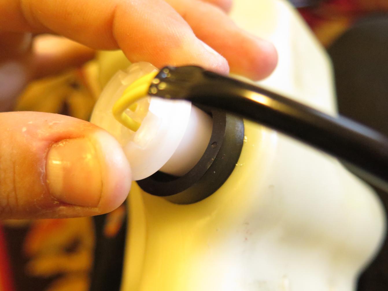

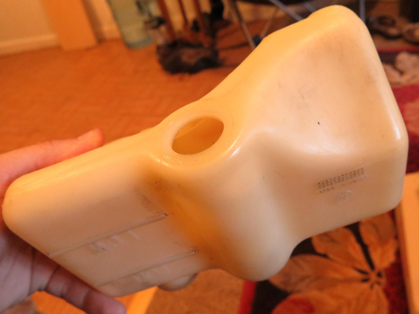

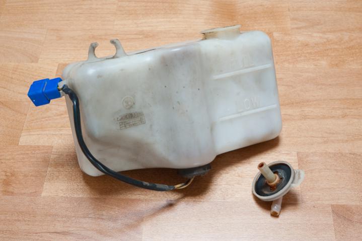

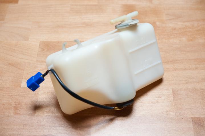

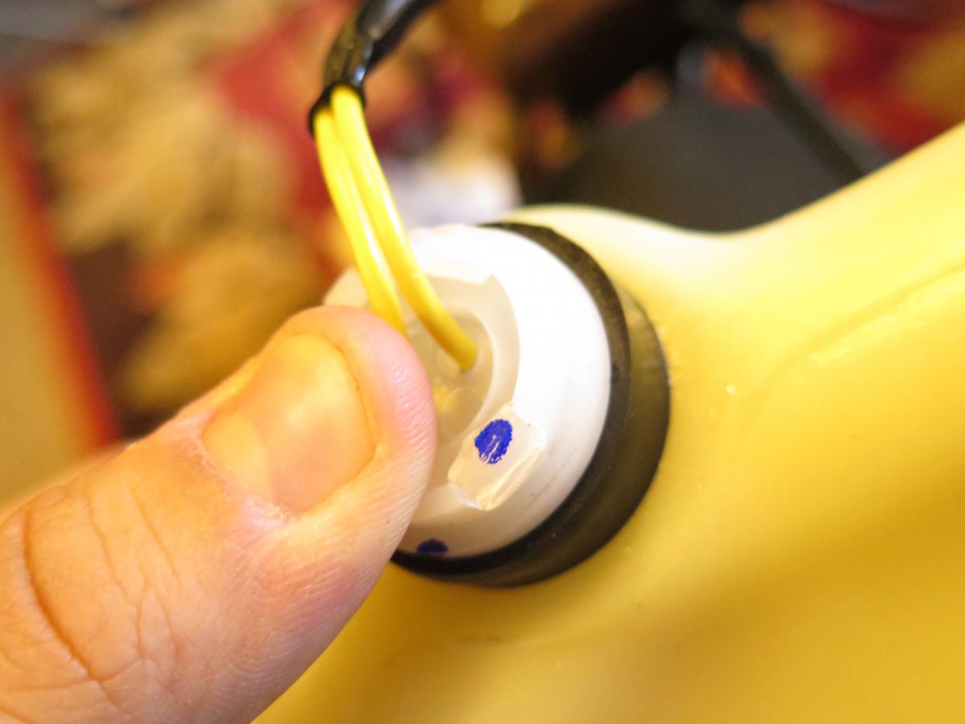

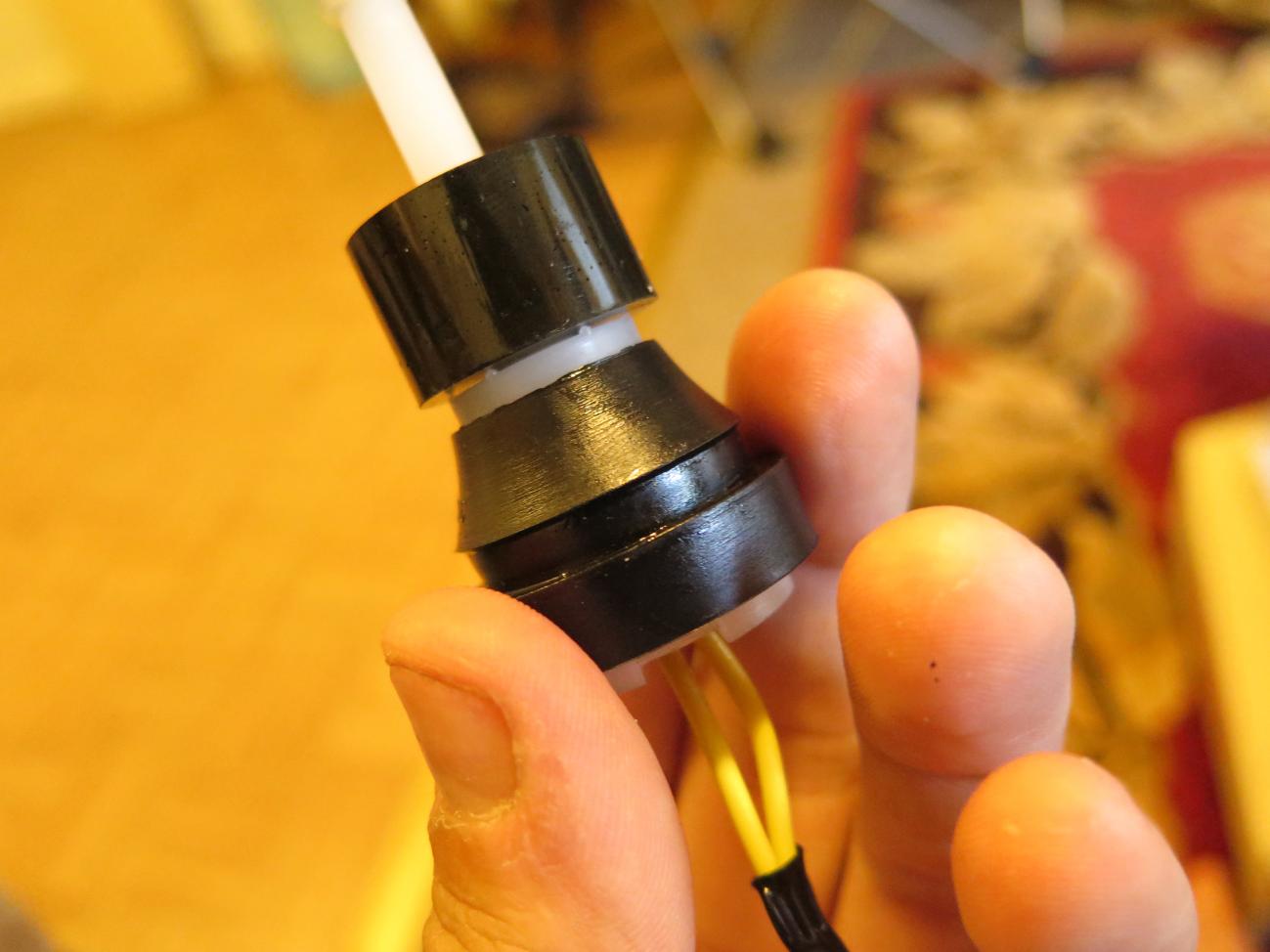

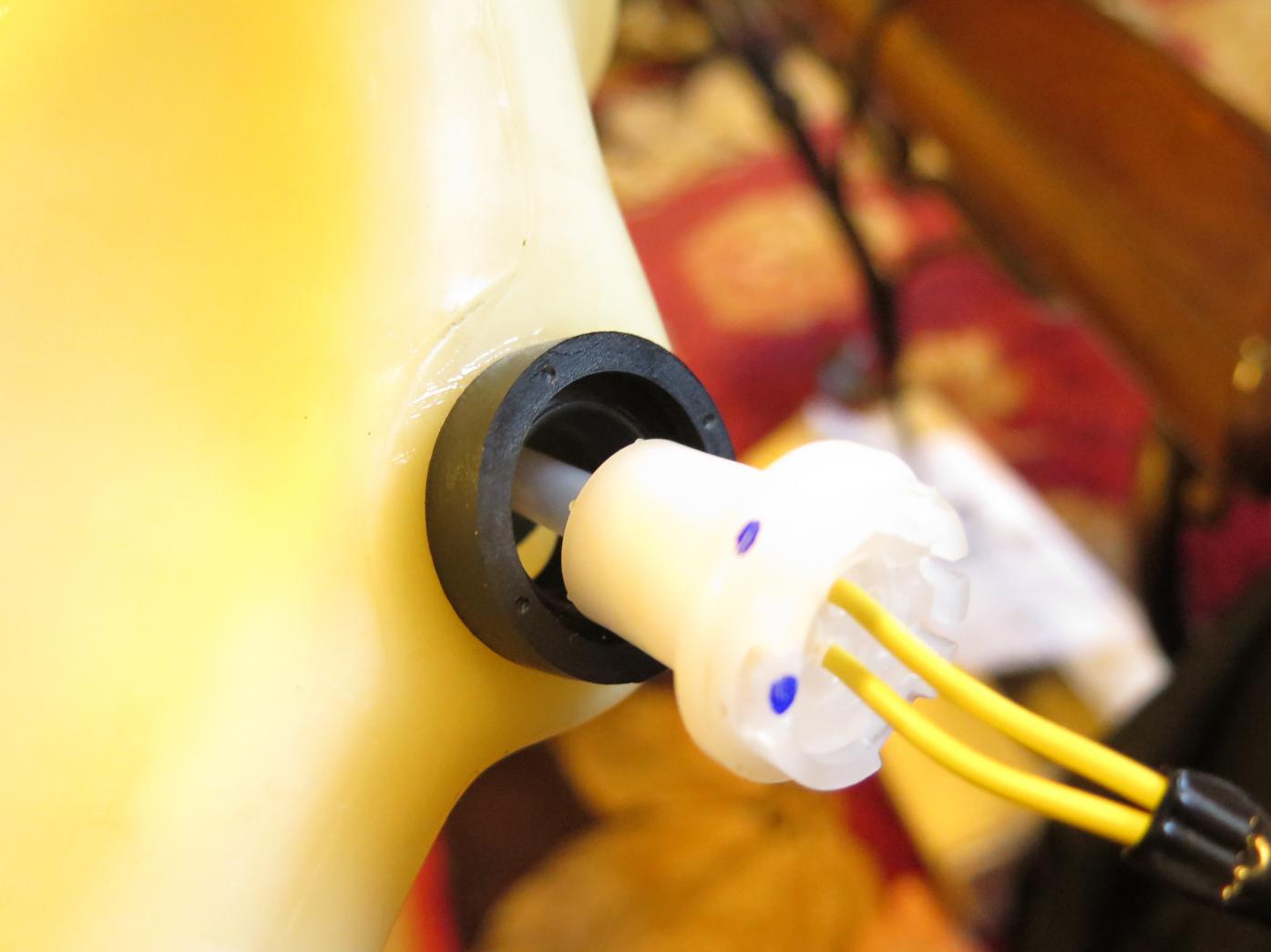

Hey Gwen. I got my new sensor and grommit. I was thinking about when you said this, and I actually did wrestle with it for a while, till my hands started to hurt. They were all sensitive and wrinkly from washing the tank out, so it wasn't mixing well with trying to get this in. Then I realized that the rubber grommit could be slid out of place from the sensor inside of it. I know I'm still really new at all of this, and this is not a huge deal, but I figured I would contribute something. So here it goes.
Got my tank all shiny and clean
Attachment 1605
here is the sensor right out of the box
Attachment 1606

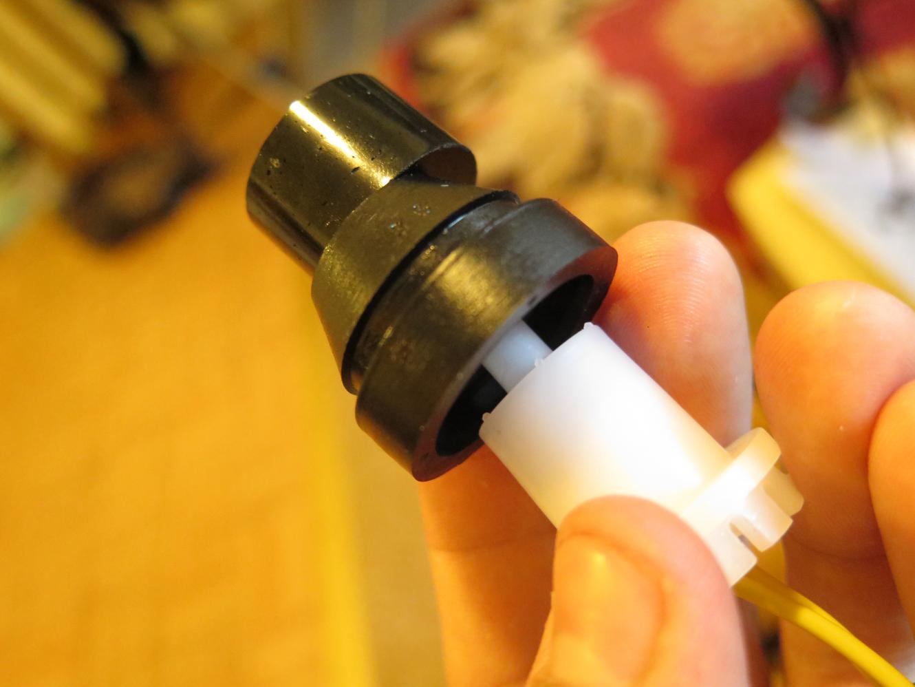

The rubber grommit can be worked out of place and slid up the sensor so that it more free to flex
Attachment 1607
First the grommit goes very easily into the hold on the tank
Attachment 1608

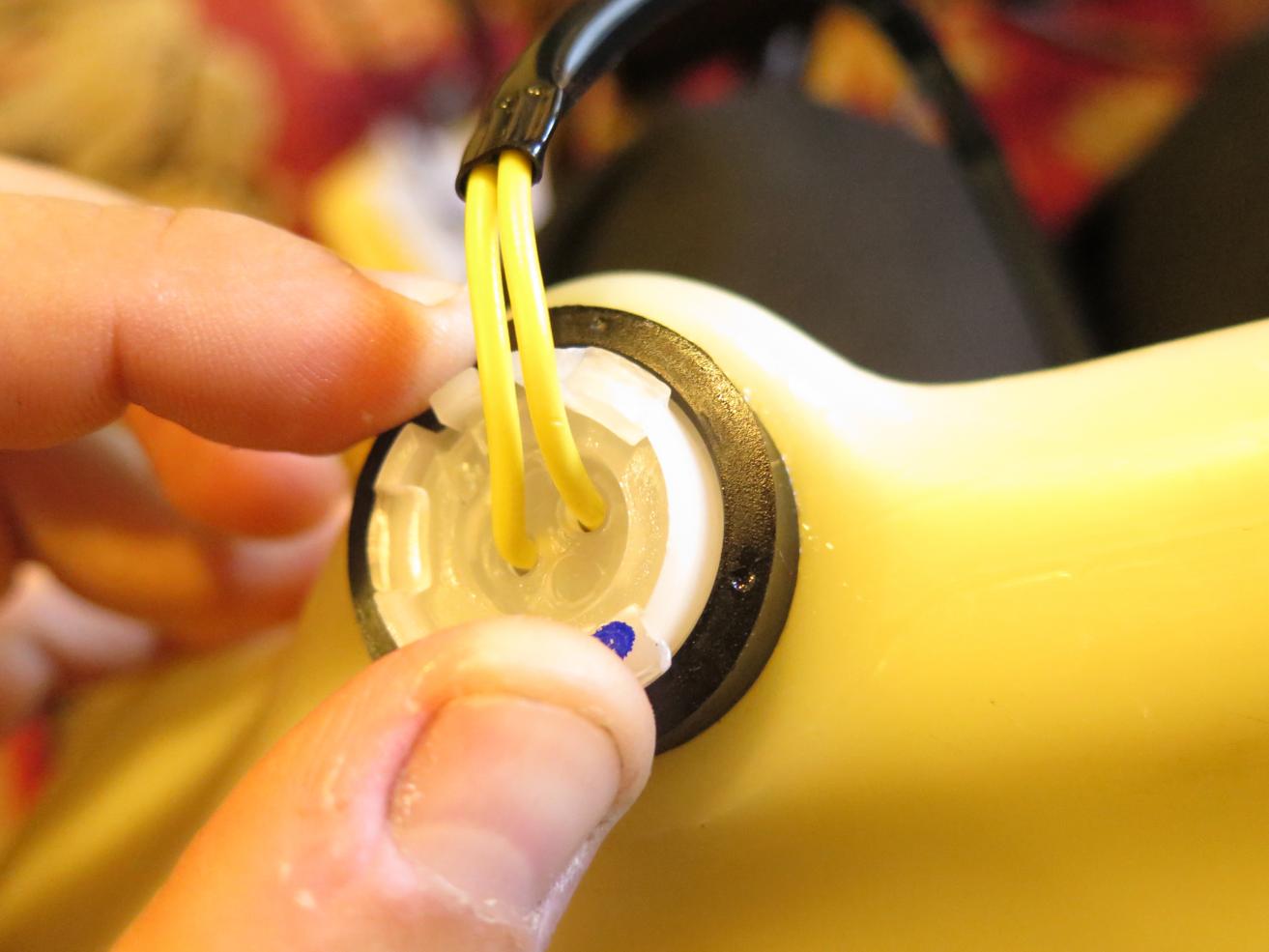

Then you can put the sensor into place, you will feel pressure, which is fine
Attachment 1609
A lot easier than trying to keep the grommit over the sensor
Attachment 1610
When you push it all the way down, the grommit will snap around the edge of the top of the sensor, sealing it in place, and viola!
Attachment 1611
