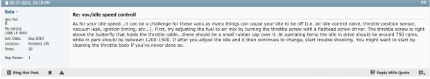

I'm a little confused tim, awhile ago I adjusted the idle per my service manual and I swear I read 1250 for park and 750 for drive???? Am i way too high? Was thinking it'd be nice to have it lower to avoid lurchy shifts.
Is this poster wrong? I think I might have seen this and been misinformed

I can't read that (too small). Idle speed is set in neutral or park. The service manual calls out 700 rpm for manual transmission and 750 for automatic. It's not a super critical thing to have it right on. I would not want "hot" idle speed to be more than 900 rpm's on an automatic as this builds heat in your transmission when sitting for long periods at a light (foot on the brake while in gear). It also puts unnecessary forces on the drive train when putting it into gear from park or neutral. Tim

Re: Idle adjustment question
Wrench
Attachment 9190
I just posted a reply to that thread to correct the misinformation.
Thanks Original. As old as it was I was previously unaware of that post. I just searched and found that thread too. To avoid future confusion I put your edit right in that post so readers won't miss it. Since that made your post redundant I deleted it.
