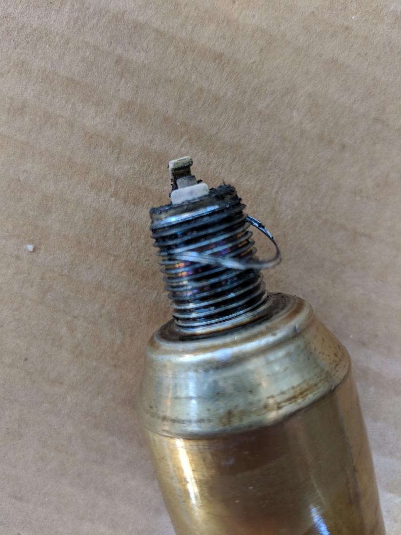

Compression test results: Cyls 2,3,4= 170psi Cyl 1 = 150 psi. Not bad overall, but a 20 psi difference?
Also - I was a little weirded out by the sparkplug situation. What is weird is that instead of the the sparkplug seating against the block, it was installed on top of the cylindrical doodad that seals agains the valve cover. Not only does it seem weird to have it between the plug's crush-washer and the motor, it looks like it has formed indentations and parts of it shear off.
I guess it's better than thinking I was looking at the aftermath of a crossthreaded plug, but this still makes me pucker. EEk!
Attachment 7067
Re: Compression test results and some sparkplug questions
I would be worried about that, it isn't normal, there shouldn't be metal debris.
You need to figure out where it came from, either the tube or the spark plug threads.
It could just be sloppy PO work and hopefully that strip is from the tube.
Did that plug come from the cylinder with lower compression?
While it doesn't look good, it isn't necessarily bad news.
If the threads in the head are intact, I would try chasing them (with a shop vac to suck as much debris as possible) and recheck the compression.
Threads can be heli-coiled if chasing them isn't sufficient, its a pain to do in-situ but not impossible.
You will want new o-ring seals for the tubes, they get hard and will leak oil.
Engine oil and spark plug wires don't get along well, so its important to keep them separated.
The shrapnel is definitely from the tube, not the engine. I'm kinda spooked by the way it's installed, and am hoping to get confirmation. Should tube be tightened between engine and plug?
Mojoworkin
Yes. The tube is soft aluminum just like the crush washer on the spark plug so don't overtighten. When in doubt use a torque wrench. Spark plug torque should be 13 ft lbs. As Burntboot said, you'll probably want new o-rings for the top of the tubes.
