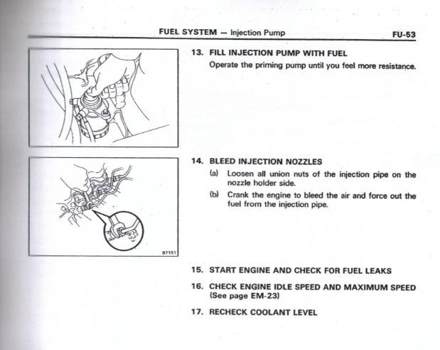

Re: MasterAce 2CT Turns over but won't start
spotted this in the manual so will give it a shot and see how we get on :D
Attachment 10350
Cheers again,
Still no luck, injectors bled, timing checked and correct. all vacuum hoses look fine..
I guess next would be compression test. Unless anyone has any other ideas..

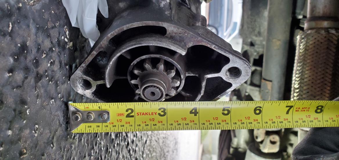

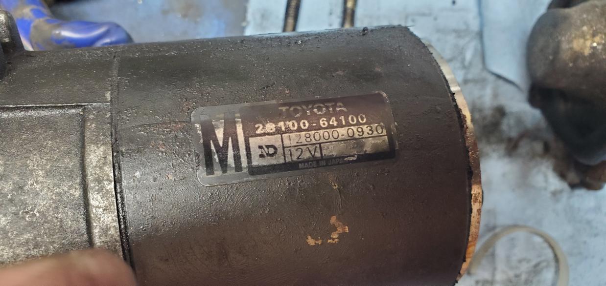

Wow...another "Surf" 2CT with a starter problem.
I am here in Florida and having trouble finding a starter. Can I inquire where you found one? My starter is a 28100-64100. 1990 MasterAceSurf Turbo Diesel 4WD and i believe its a 1.4kW starter.
Cheers
GeoBus
Attachment 10391Attachment 10390Attachment 10389

My Starter was a 28100-64040 2kw which also seems to be what is listed as the correct kw for the 2CT 4WD Auto (i have an auto) (I also found my replacement on ebay, which does particularly help you)
http://www.townace.plus.com/aanswers.htm townace.plus has some good points and also the part number for the blueprint equivilent: ADT31227
I also find this website helps to find out part numbers: https://www.megazip.net/zapchasti-dl...0g-pqzx-913857
Also I find Yoyopart to be really good for finding alternative interchangable parts: https://www.yoyopart.com/oem/6992735...810064100.html
As for stateside parts i'm not sure as I'm in the UK but someone else on here might be able to help out with at?
Hope this helps.
