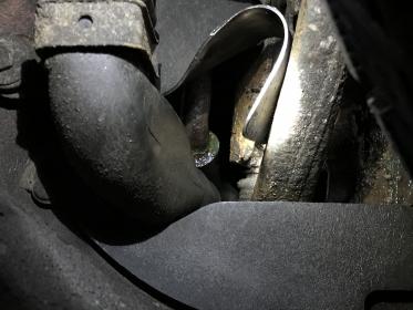

Enough to realize, unfortunately was not a bad hose. Well not that I could see
Its leaking from the rad., near the outlet hose. very sus

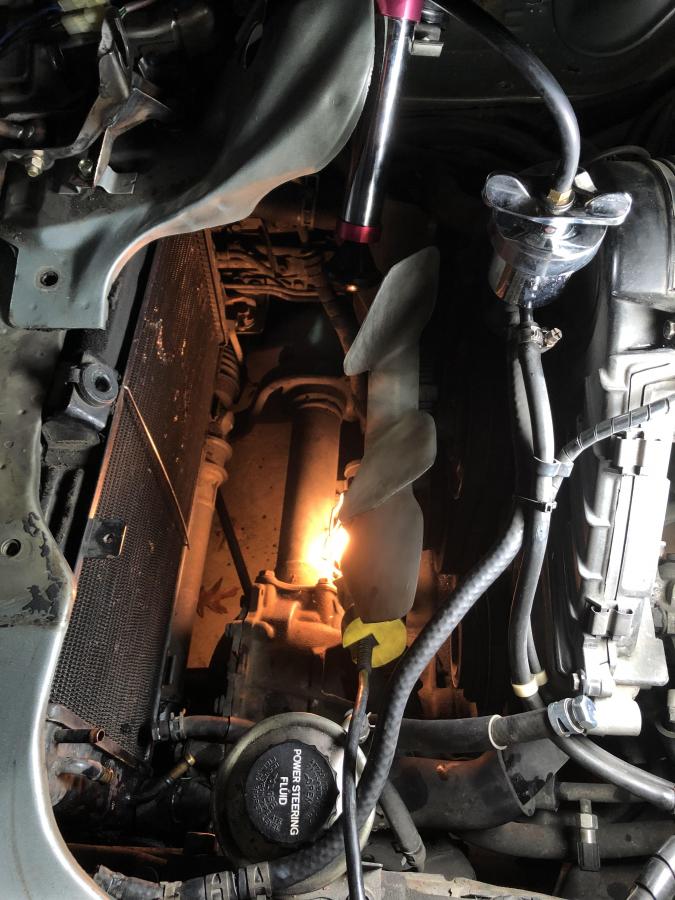

So I'm trying to remove rad and get a better view.
Attachment 10770
Man those radiator hoses, inlet and outlet are very stuck on.
I even tried using a propane torch to warm up the hose but that didn't help it slide off. :cnfsd:
any other advice outside of cutting them off? I'm in a hold position until
a) find replacement hose. then can cut off old hoses and replace.
b) Add lube, keep prying, keep twisting, keep pulling, slip them off. :dance2: and then they fail later. :bdmd:

I think I found the culprit in my case today after trying to refill the cooling system,
Attachment 10771Attachment 10771
Re: Bad Coolant Leak + Overheating
Glad you found it, I don't see it. What do you have to replace?
I got my rad yanked out today. man that was tough and tight.
Those tools helped break loose the hoses from the rad, bought a set for $28.
Now to find a rad shop in town to fix it.....:?: or verify the leak :cnfsd:
Plan to take the hoses to the O'Reilies up the street and see of I can get a close enough match.
Guy told me they have about 500 in the back I can try to match up to. yay for me.
