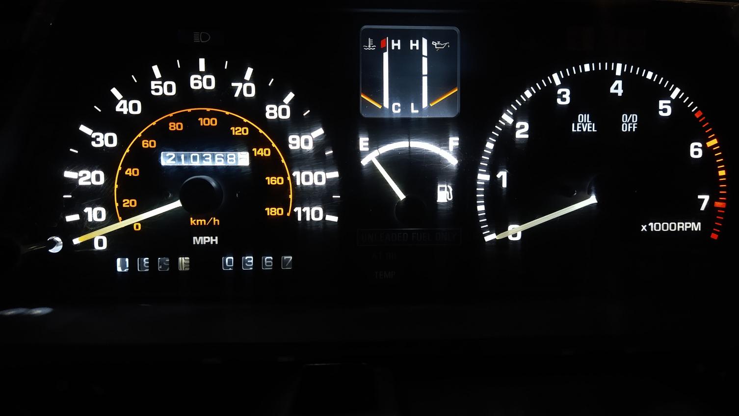

Attachment 11068Through TVT friends here and posts on how to remove the instrument cluster, I changed out the dash bulbs to white LEDs, here's a photo attached.

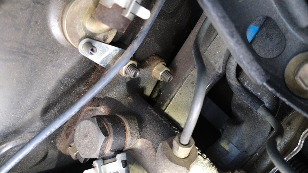

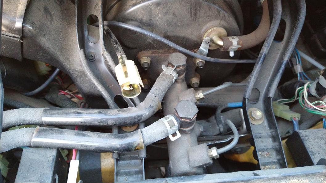

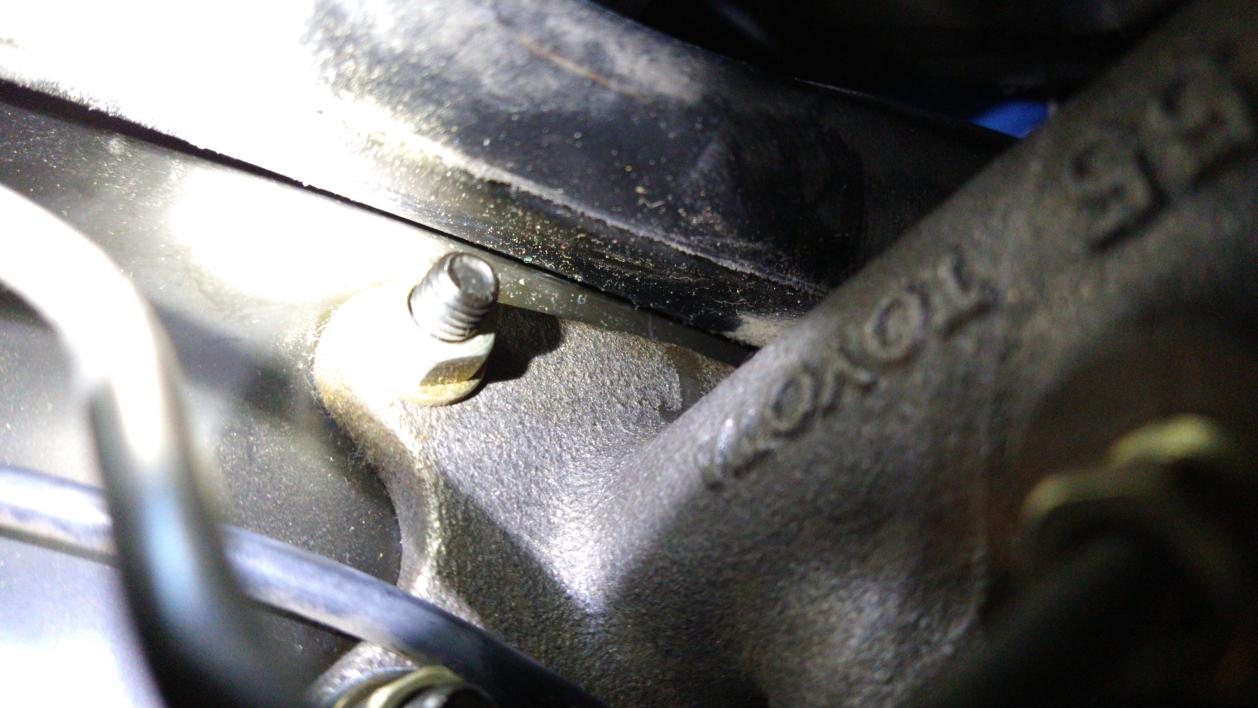

Also I got into the dash to inspect my master cylinder and need some opinions if I should change it out. The brakes seem to grab fine, although they pull to the left when it is pressed hard, but I saw some fluid on the floor mat. It was dark, but it was not the color in the reservoir golden brown. I was contemplating changing out the master, but not 100% if I should. I am not familiar with changing it out, but would be a complete swap and bleed?
I am attaching some pics to this and appreciate any input.
Attachment 11065Attachment 11066Attachment 11067Attachment 11068

Wow LED’s look great, which bulb size/brand did you use?

JDM- my apologies for the huge photo, just realized that! Not sure how to resize it. For the LEDs, I used the Serundo Auto I found on Amazon: https://www.amazon.com/gp/product/B0...?ie=UTF8&psc=1.

Thank you for the link, as for the Brake Master I personally had mine replaced when it started leaking on my shoe, it hadn't failed completely but I didn't want to take any chances. Sorry I had taken it into the shop so I don't have much to offer except a couple of threads that have covered the topic-
https://www.toyotavantech.com/forum/...t=brake+master
Check out those threads and post in one of them and you'll probably get a quicker reply. Good luck!!:thmbup:

ive had great success with LEDs from amazon, they make a huge difference.changed ALL interior lamps in 3 vehicles! when you change the MC, consider replacing any flexible lines.
