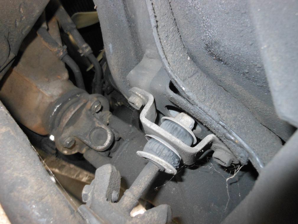

I believe this is part of a front sway bar on a 87 4x4, all pics are to my 4x4, but I'm betting that this is valid for many other vans here,
MOD EDIT — These are called front stabilizer cushions. They are part of the stabilizer bar system.

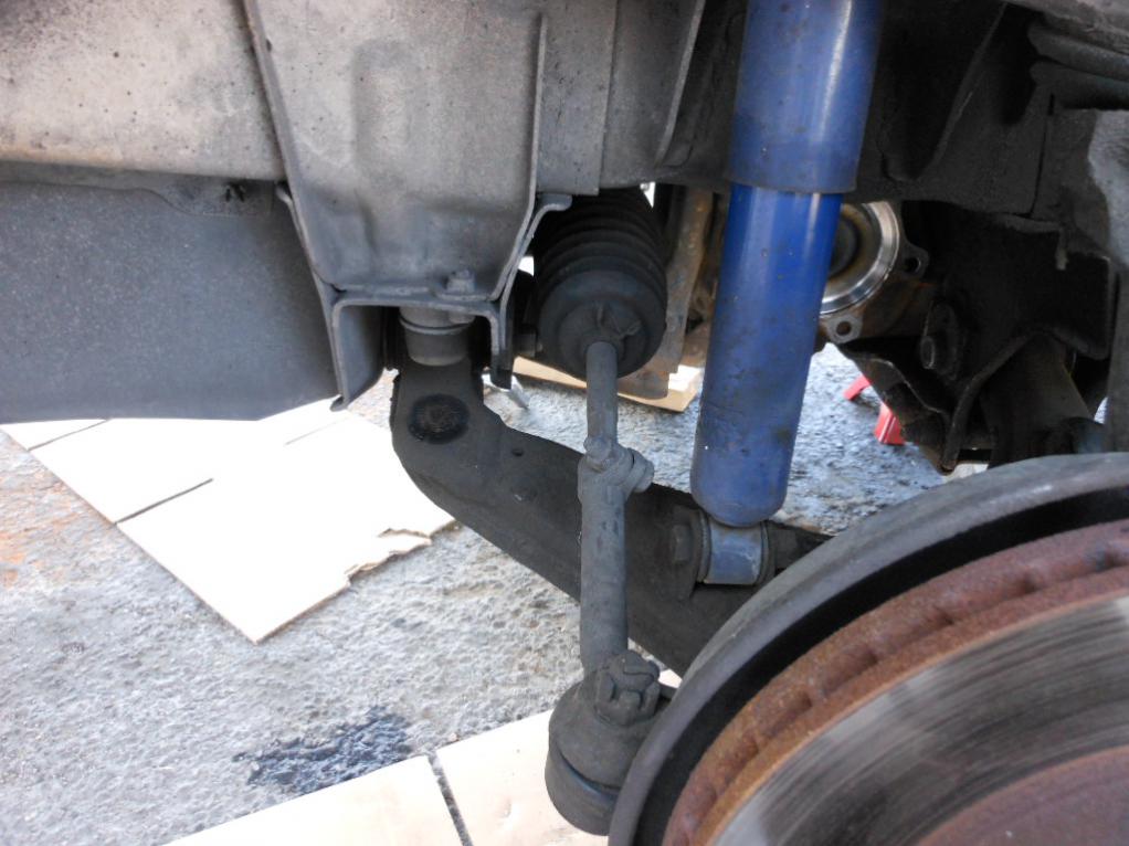

MOD EDIT — The rubber bumper for the lower A-Arm is: BUMPER, FRONT SPRING, NO.2. The accordion rubber boot is: BOOT, STEERING RACK, NO.2. In the picture below, the drive axle and boot are removed (not visible).

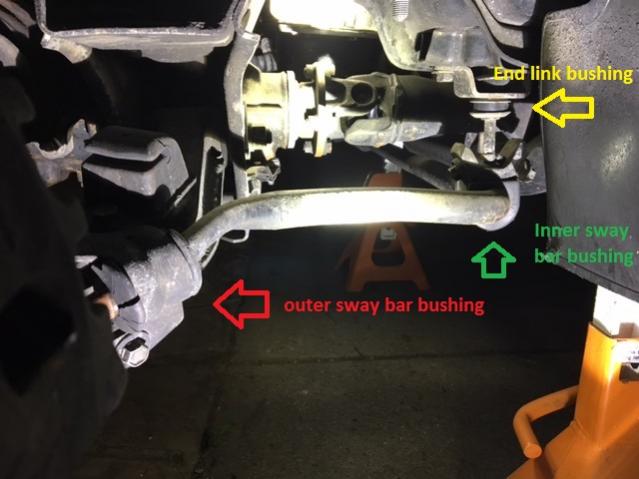

bushings, bushings, bushings ...........
Slippery slope working on this van. Anyone have links or part numbers to replacements? Short of that I'll likely just take all of them down to FLAPS and try and find something that works.

Swaybar Bushings,, Motor mounts,,,,Recco's?
...took the van into the front-end shop,, expecting to find something loose,,, turns out it's mah ass that's wiggling! :dizzy:
Here's my shopping list,,, is there some place on line that's 'one-stop' for all of these?.... any recommendations of type, etc?? 1986 2WD
Sway Bar Bushings... all of them.

Re: Swaybar Bushings,, Motor mounts,,,, Source?
.....found these at Autoparts warehouse... said to be a direct fit for 86 2wd.... is there other bushings anywhere in the swaybar???

Duplication. The small bits in the bottom of the first picture assemble into the same part. The oil level sensor has an o-ring type seal. The part number is posted on the site in a few threads you'll have to search for that one.

...thanks,, is there any other bushings needed for the swaybar?

....yes,, found that when I did my hunt,,, it's labeled as for 4x4, mostly front.... not clearwhat applies to a 2wd rear swaybar. :?:
