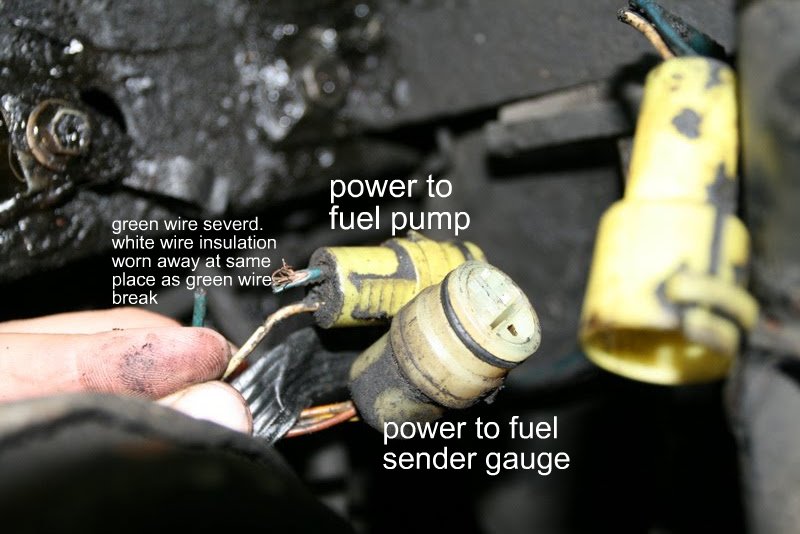

Update on my disappearing short: A couple days ago my van broke down due to lack of fuel. Unfortunate that it was in Canada and had to be towed to the USA (pita). Glad I have unlimited towing (better world club) as I've already used it three times this year, but that's not the point of this post. This breakdown was due to lack of fuel. I checked the wires going to the fuel pump and fuel gauge sender. The wires to the pump were bare / severed, both in approximately the same place. This must have been the source of my intermittent 0.36A battery drain. Sound plausible? I bet that plug became jostled and un-shorted when I disconnected my starter, and that is why I thought the starter was the drain. Here is a pic.
Attachment 745
Re: Slow battery drain, procedure for checking?
Plausible I guess except this is a fused circuit & powered off when the ignition switch is turned off. The draw should have disappeared when you pulled all the fuses. One other thing I previously forgot to mention is the position of the ignition tumbler assy. If you look close at the tumbler (place where you put the key in) you will see it's labeled "Lock", "Acc", "On", & "Start". The key is only supposed to come out when in the "Lock" position, but these are cheesy tumblers & when they get worn the key can be removed from any position. Sometimes "van newbies" don't realize this and will pull the key out while the tumbler is in the "Acc" position, thus leaving some circuits powered up. I'm sure this isn't the case, but wanted to make sure you were aware of this possibility. For the record, (this is for the future benefit of newbies), in order to get the key to the "Off" position, the little black button above the key slot must be pushed while you're rotating the key. Tim
What if the two wires were not shorting with one another, but the + cable shorting with ground on the chassis? I am rather new to thinking about electricity, so maybe I am way off base. I finally reinstalled my stereo (just a deck) and am only drawing <=0.05A. The drain has not reappeared.
Good point. I did check the tumbler several times... thinking that I must have made a silly mistake the key turned or the door ajar. The tumbler was always in the 'off' position. Depending on which key I use, I can pull it out in most any position. So I was wondering if the tumbler could be causing the drain even though it was set to 'off'.
Now that everything is back together I can't stop blowing dome fuses. Every time I put one in it will instantly blow if the engine is running and I open a door or flip on a dome light. If the engine is off (not sure if this is with key out or in) then the fuse doesn't blow.

Final solution found. The real short was at the wiring to the driver door light fixture :wall:. The door panel is not properly attached to the door and closing the door caused the light fixture wires to chafe on the door... at first this caused the 0.36A draw, later my DOME fuse would simply blow as soon as I put it in.
