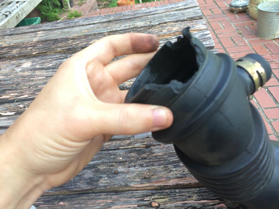

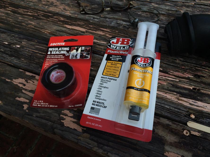

Decided to see how long a mended air hose will hold up, at least until I order a new one from Toyota. Here's what I did (I'll update after some heavy driving to let y'all know how well it holds up).
1. removed the air hose, located and cleaned the cracks.
2. glued the cracks closed with JB WELD Plasticweld 2 part epoxy

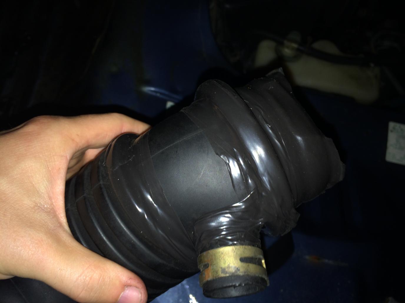

3. after the epoxy was cured I wrapped the cracked and suspect joints with high heat "insulating and sealing wrap" tape
4. popped it back in.

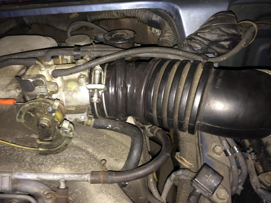

I started the van and my rough idle is gone even when fussing wit the air hose, earlier if I touched it at all I the van would immediately shutter and almost stall.

Attachment 1589
supplies

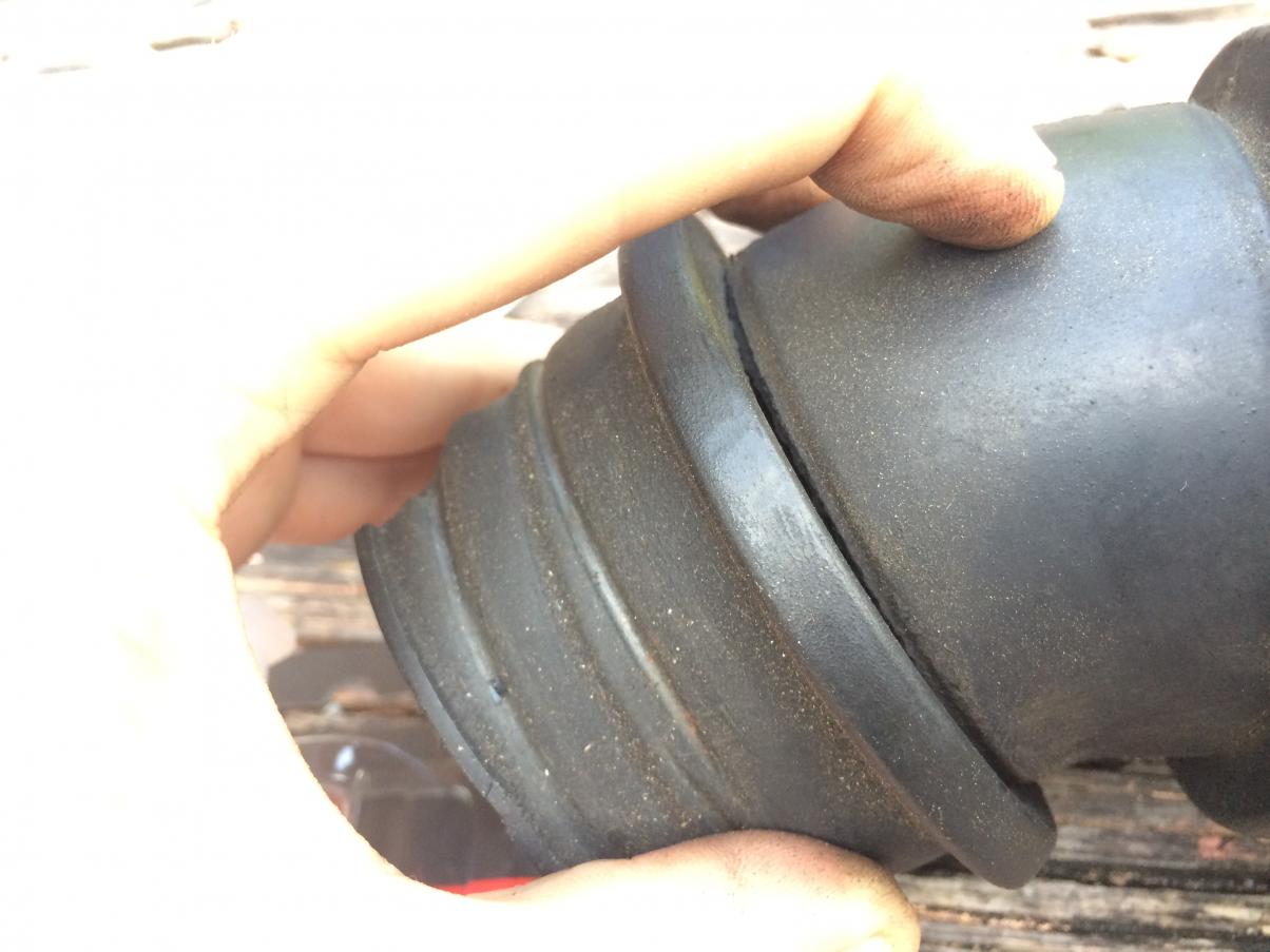

Attachment 1585
here is the main crack
Attachment 1586
wrapped this missing chunk with tape upon reinserting it, seems to be airtight...
Attachment 1587
here is the piece after applying epoxy and tape (kind of did this in the dark, just noticed it's a little sloppier than it could be)
Attachment 1588
all put back together
