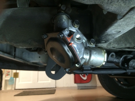

Well I'm happy to report that in January 2018 it is still possible to have this recall remedied...
first, go to the NHTSA site to plug in your VIN# (to see whether your van has been fixed or not)... http://vinrcl.safercar.gov/vin/
Attachment 6705
Thank You to the wonderful service and parts department at Don Jacob's Toyota in Milwaukee !!!
The part is still somehow available, and, although I wasn't expecting to notice the difference, I can report that as i drove out of the dealership it felt unbelievably tight- like a brand new van.

Lost the part #s I had looked up; but I remember about $600 (list) ... with most places selling for about $450
(also, at first my dealer said my part #s weren't coming up right ... (new numbering system now ?)...nevertheless, they called 2 days later and said they had the part in and were ready for me to drop off the van.
