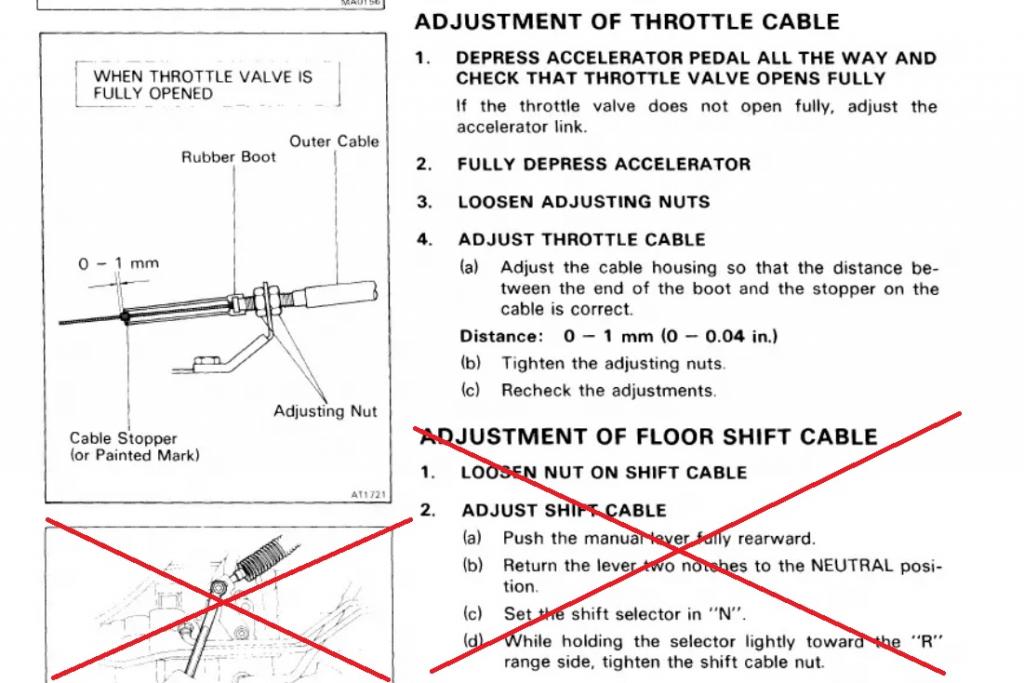

For the leak on the rear axle, do you mean the rear axles from the differential to the rear wheels? If so the issue with that is not so much the leak itself, but if too much of the oil (gear oil) leaks out, there won't be enough to lubricate the gears and they will destroy themselves. This shouldn't be causing your shift issues, but I'd check the level in the differential to make sure there's still oil in it. Remove the fill plug and check with your finger that there's oil in there. The level is supposed to be up to that hole or close to it. The harsh shifting issue could be caused by an out-of-adjustment cable at the throttle. This linkage adjusts fluid pressure and shift points in the transmission. It seems strange that it would only affect the shift in one gear, but it's worth checking on the adjustment. This image is from an '87 van, but the procedure should be the same.Attachment 12936
