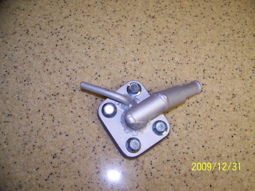

Hola Tim & Gwen,
Here are pics of my machined water outflow plate/hose of death plate:
Attachment 800
One pic inserted, and one as an attachment. Not sure what I did wrong there.
Alaskanherbs: Basically you will have to remove the old outlet plate and take it to a machine shop. If I remember correctly
they charged me $100. The other option is to yank one off of a junkyard van. Problem is they are so old it might be corroded
and full of pin-holes like mine was.
