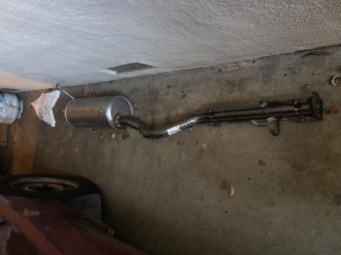

So to my surprise and delight I was able to purchase a brand new muffler and exhaust pipe unit from Toyota for $200. According to the dealership there is only one other left in USA inventory so act fast.
Attachment 3802
Next to my surprise is that the old muffler combo was easily unbolted from the catalytic converter. Finally a project that was going well! OR NOT... I can not figure out how to get it out of the car. I got the 2 bolts off and and all the suspension rubber parts off but no matter how I twist it, move it, push it, it gets jammed up on the rear drivetrain / random pipe / brake line. I could just cut the old out one, but I would have the same issue getting the new unit back in.
I did search the forums and even looked through the repair manual with no luck finding anything about how to properly remove/ install the muffler unit.
Re: Replacing the Muffler - Super frustrating!
You will likely need to jack the van from the body to increase the distance between the rear axle and the body. There are 2 jack points, one on each side (low hanging spot on the front side of each rear wheel well). If you only have one jack, jack it from the differential and put your jack stands under those jack points, then lower the diff (let it hang). As always, when jacking a vehicle, be careful and don't take chances. Tim
Since I already had all the bands and bolts off, I was able to jack it up on the drivers side back only and pull the old muffler right out! So easy!
