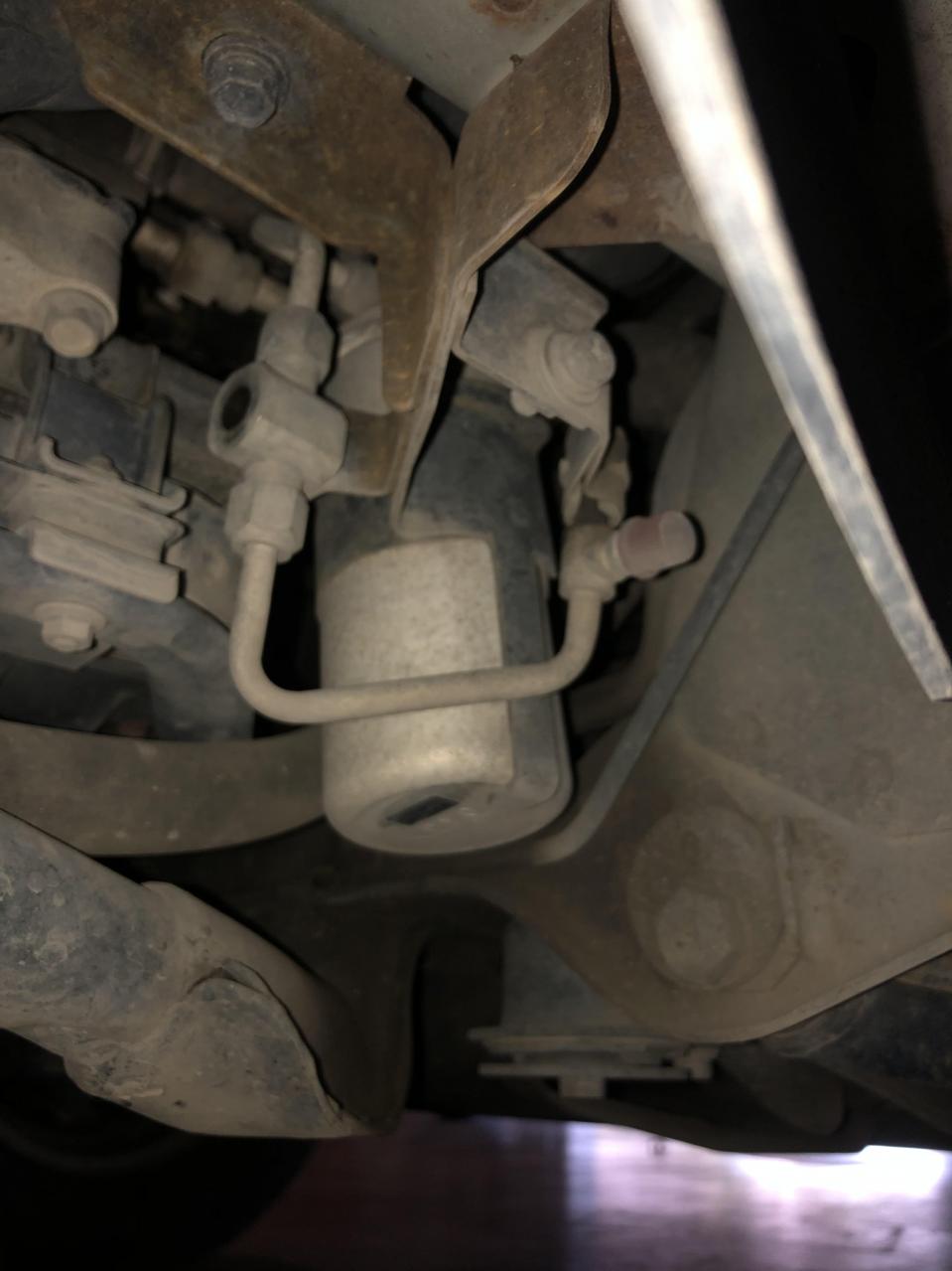

I grabbed your quote tim because, on the front of my van ('93JDM) where the sight glass is, I only have one port there. I'm guessing there are more ports found throughout the lines but would that be the refill port on this system since it is right at the sight glass?
Attachment 11161
That red cap is the high side. The low side is more towards the front of the vehicle, and on a larger diameter tubing. On my vehicle, it had a black cap. I can post a photo if you don't see it.
