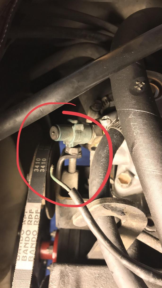

Attachment 8684the part i'm looking is the idle up temp switch #8942820050 and I believe i found it on RockAuto.
https://www.rockauto.com/en/moreinfo...sn=257&jsn=257
I don't think I need to buy it, i just don't know how to reconnect the disconnected cable? Can you please help.

That particular plug will need to be repaired. If it were me, I would take the female part of the plug off and use a crimp for now until you fix or replace the broken one.
The idle up temp switch isn't going to have any ill consequences if you fore go it for a while though... thats the good news
iq_artwork
That's your "pressure-up" temperature switch. With the changing gas markets it's pretty useless (way out of range for the boiling temp of modern gasoline). Just leave the sensor disconnected and connect that wire to ground. Connecting the wire to ground will send a signal to your ECU telling it the engine is running hot, and that will increase the fuel pressure for ~2 minutes after each start-up. With summer coming on that will help combat the effects of HEAT SOAK. Tim

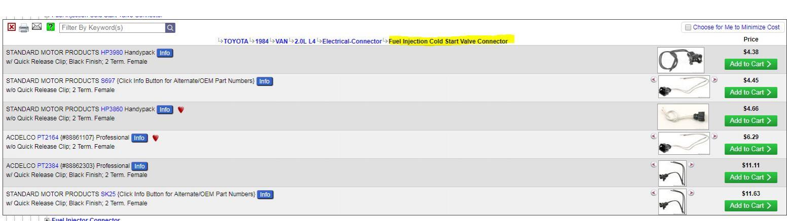

Hello guys,
for my disconnect cold start igniter cable, I'm planning to buy a new one and replace it. I found few at the Rockauto but not sure, are all of them the same? Which one do you recommend me to get?
Or can you send me please the part number.
thank you!!
