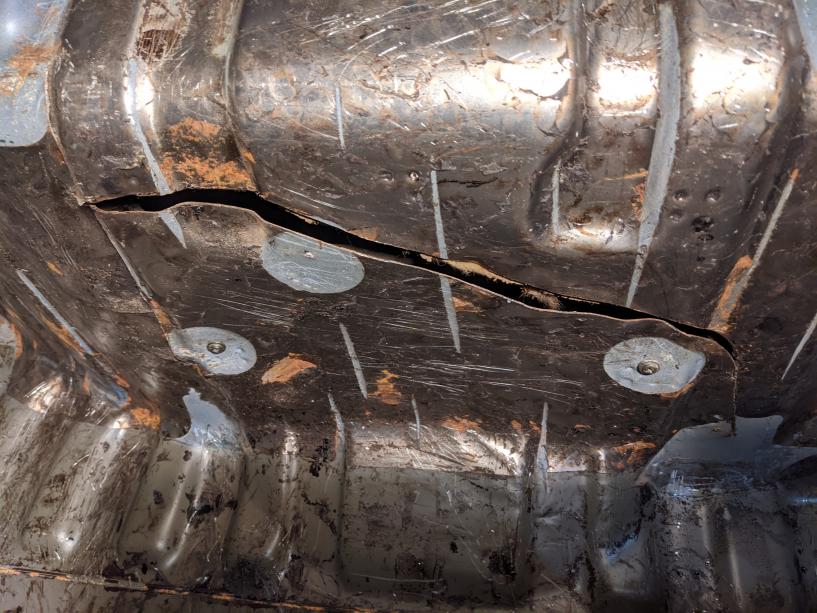

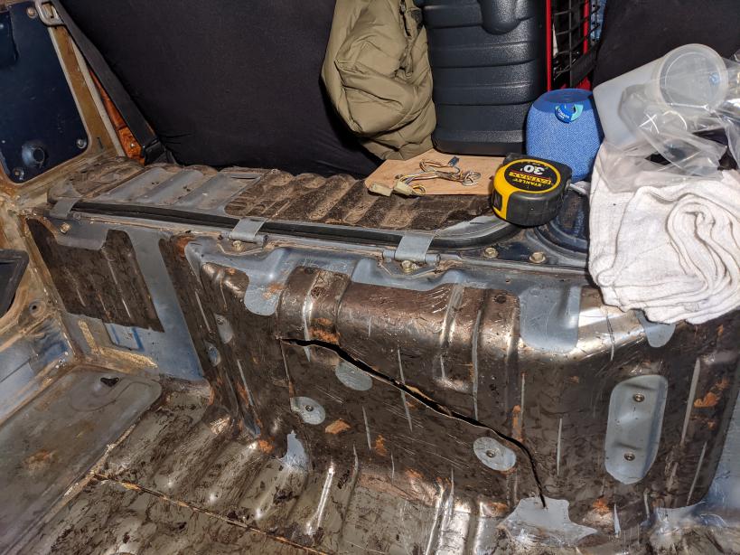

Sometime in the vans history, the back firewall was chopped into to gain access to the back of the engine. After removing the back heater vent, discovered a poor attempt at a fiberglass repair and finally discovered where my exhaust fumes have been seeping in :dizzy:
Before I weld it back, wondering if there's a good reason to keep a removable panel here instead of patching it up completely? I assume it must of made some PIA job easier in the past. Does this give access to "the hose of death" I've heard about or some transmission bolt that's otherwise impossible to reach?

Wondering which parts (part#s) I may want to inspect or stock up on/replace while I still have easy access?
Wow, that's a nasty looking hack job. There is a benefit to having some access here, but it's hard to imagine a cut like that helping much. If it were mine I'd weld/patch that, then maybe put a more reasonable access hole there if/when needed.
Here's an example of a more reasonable way to get access to the "hose of death"
http://i8.photobucket.com/albums/a23...04IMG_8847.jpg
http://i8.photobucket.com/albums/a23...09IMG_8966.jpg

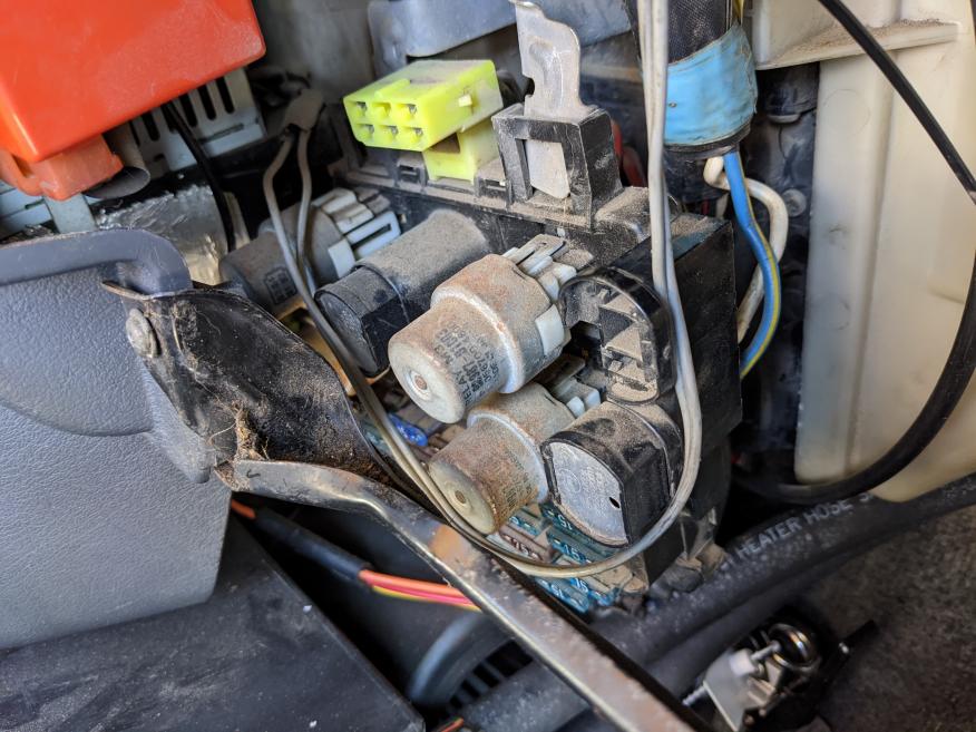

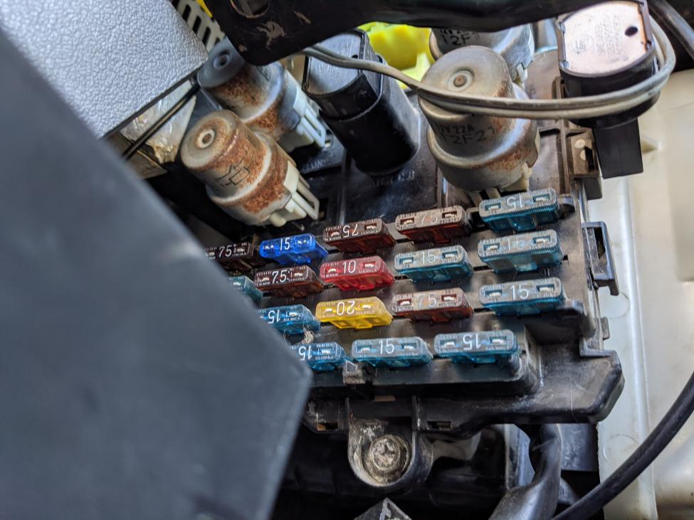

Where is the hazard light relay located?
Attached is photo of fuse panel but none of the relays seem to be labeled hazard.
I'm on a road trip, got pulled over for no tail/break lights(solved) but learned in the process that hazards don't work. Fuse is fine, next guess is relay but forgot my manual at home.

Oh oh thats not good, look at posting number 4 in this thread-
https://www.toyotavantech.com/forum/...t=hazard+relay
hope this helps:thmbup:
