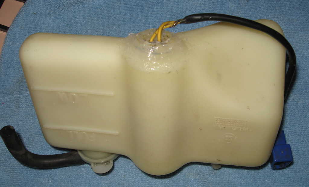

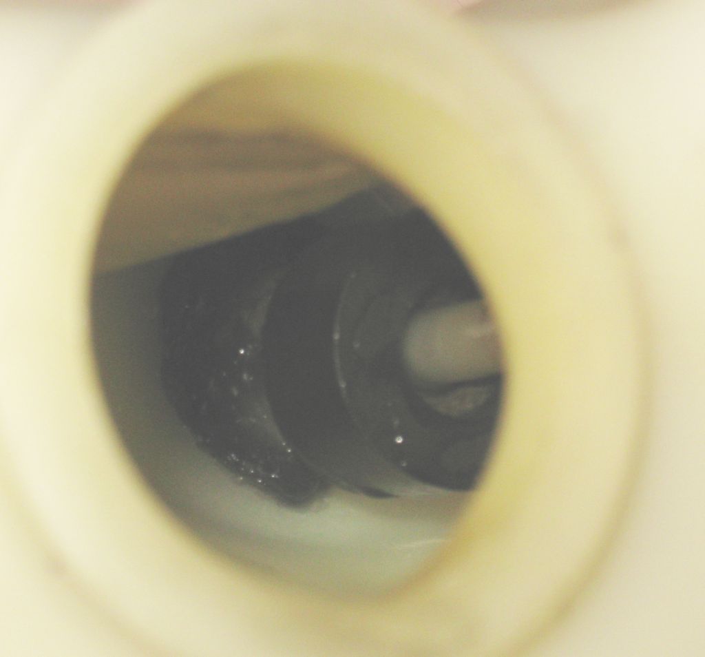

I'm trying to repair my own deteriorated coolant level sensor grommet ($100 for a new sensor and grommet feels too expensive to me for now, especially when there's nothing wrong with the sensor). My first attempt was to clean and dry everything, and then use what was left of the bottom piece of the grommet and a bunch of high temp black RTV to goop it liberally to try to seal it up:
Attachment 1633Attachment 1634
I let it set, taped in place with masking tape, for a couple of days (RTV tube said 24 hours). I filled it with water and let it sit over a jar for a day: no leaks. I put it in service, and it leaked all of the coolant out before five miles had passed. Doh!
The RTV had not adhered to the remains of the old rubber grommet. I suppose heating up worked the rubber a bit and the RTV's tenuous hold on the old rubber came undone.
I'm searching for a standard grommet that will fit (3/4" Bore, 1/8" groove width, 1" groove diameter, thickness and OD don't matter), and if I find one and it works I'll post it. It would be missing the sleeve that surrounds the float (which I've read is supposed to keep the sensor from indicating low fluid under hard braking), but if it seals it'll be fine.
If that doesn't work I'm going with the expandable rubber freeze plug suggested above.
The plastic welding idea is a good one; the sensor bottom flange is actually a little bit wider than the hole so there may be enough material to weld without adding donor plastic.
Thanks to all for the discussion and ideas.
John

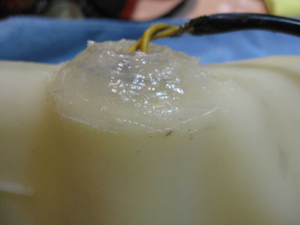

I got impatient with my search for a grommet...it's not the kind of item that's very common and I wasn't able to find one to try locally, so I shifted to trying just high-temp RTV to glue the sensor into the hole, leaving out the remnant of the original rubber this time. The base flange of the sensor assembly is slightly larger than the hole in the reservoir.
I cleaned the RTV left from the first try, scrubbed the surfaces that would touch the RTV with ScotchBrite, and cleaned them with alcohol. Inserted the float partway in, then using Silco RTV 4500 high strength silicone sealant, a nice bead was run on the bottom of the reservoir around the hole, and a bead around the bottom of the sensor assembly (the part just above the bottom flange):
Attachment 1639
Gently pushed the sensor flange into the silicone, so there was still about 1/16th of an inch before the flange reached the tank surface, then used a small strip of cardboard to smear the silicone into a fillet around the flange:
Attachment 1640 Attachment 1641 Attachment 1642
I left it turned upside down like that for 24 hours, then turned it right side up and filled it with near-boiling water from the teapot, waited a half hour or so with no leakage, then capped the filler hole and shook it up and down pretty hard for a minute or so with no leakage. It feels pretty secure. I'll try it in the van and see how it does.
If you've read this far, thanks for your patience...

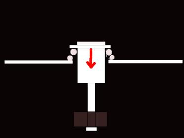

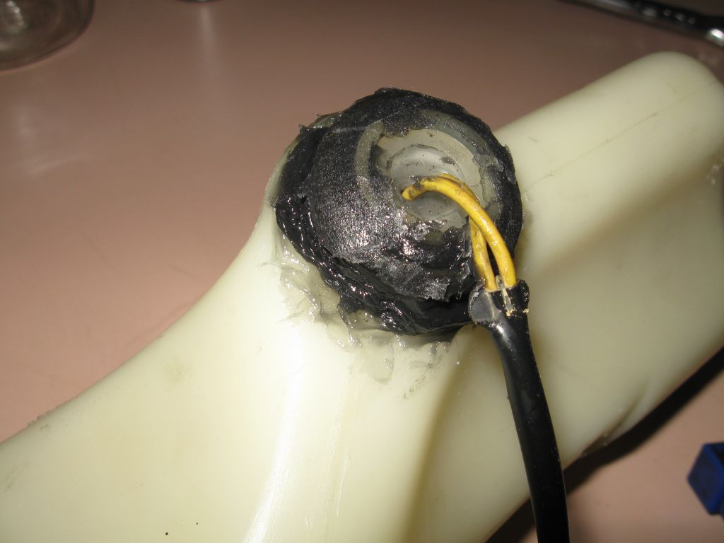

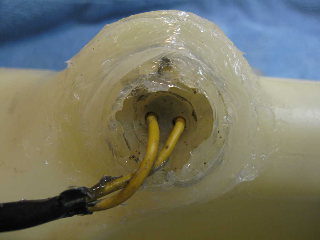

I agree $100 is kind of steep; so I thought about it and went to auto store and looked for something that I might be able to use as a replacement and I found a PVC Valve Grommet from Dorman #42313 that looked like a good fit (Pic1&2). I turned the grommet inside out and marked it with a pen (Pic3), than I cut out a groove with an exacto knife than filed it smooth (Pic4) and returned it to its original position (Pic5), I had to work it onto the top of the sensor by stretching it out and flipping it inside out than pushing to down the shaft and flipping it into position so the groove I filed out fit over the disk on the bottom of the sensor (Pic6) I had to use a small screwdriver to work it back into the tank (Pic7) filled the tank and placed it in a small bucket over night no leaks. Hope this helps Ralph
Re: Coolant Reservoir Leak
Nice work, Ralph. I'm betting it'll seal well when hot, too.

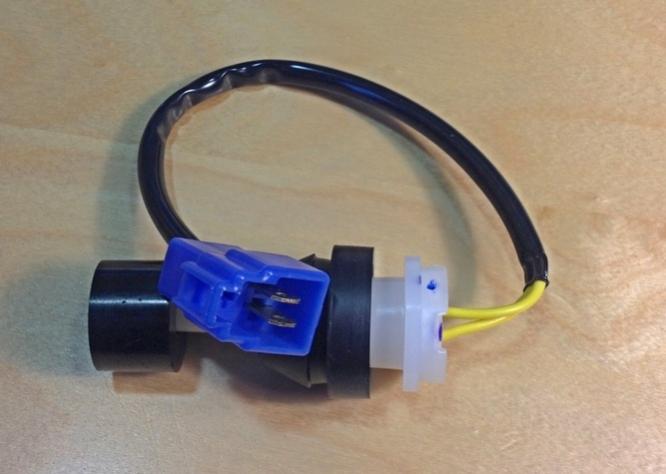

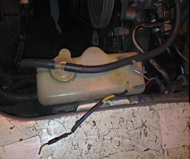

Coolant Level Sensor Replacement
Ok, so I bought the new coolant level sensor from Toyota. The wires that lead to it have been hacked-up a few times so there is no connector to plug into the new sensor. I'm no electrician, so any guidance appreciated. Thanks!
Attachment 3789
Attachment 3790
