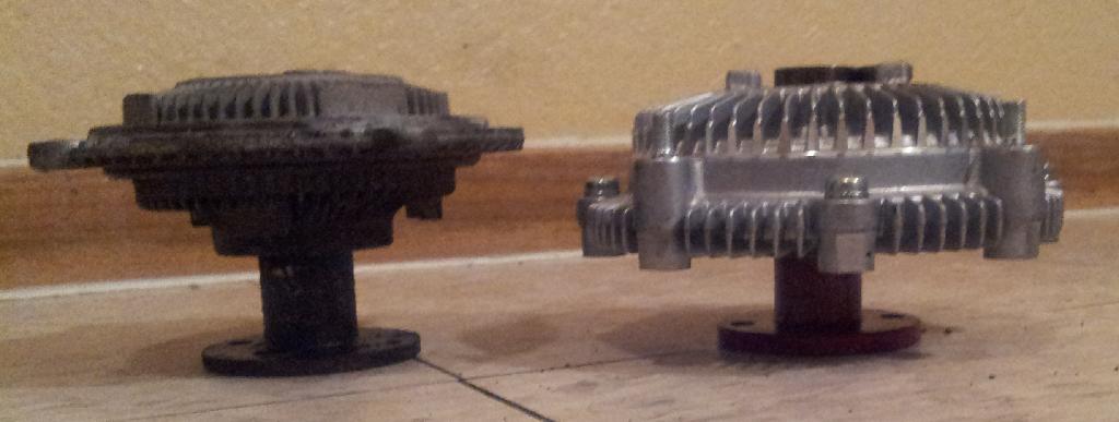

That looks exactly like the OEM one I installed a few months ago. It's the one on the right in this picture:Attachment 1974
