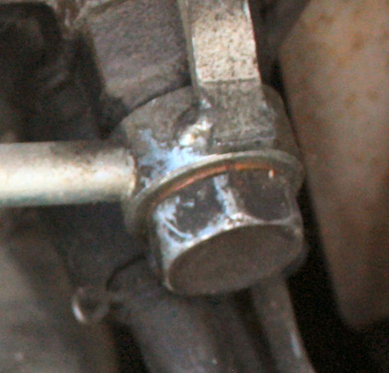

Friend did not have the right size socket - which turns out to be 22mm - but does have the 12-point box wrench. Will that be OK to use on this bolt?

12 points are okay for nuts & bolts that aren't already messed up. I don't know how bad yours is, but it will probably work. Tim
Here's an extreme close-up shot - click to enlarge.
Attachment 1109
It was in this condition when I first looked at it, by the way.
It doesn't look that bad. 12 point will probably work fine, but here's the thing........If it slips there probably won't be enough left for a 6 point. If you start off with a 6 point, then you don't need to worry about it. Tim
I got the bolt off!! One good push with the cheater pipe and it popped open! :thmbup:
