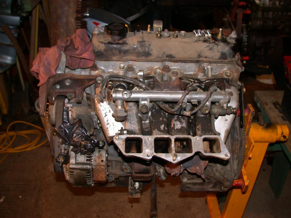

All I can say is that if (when) I do this again, I would split the air chamber from the intake manifold early in the game, maybe even before removing the engine. Yes, it takes a few more minutes and buys another gasket (at least one) but saves headache and stress (super easy to unclip injector wires and unbolt manifolds).
While preparing to separate, I broke the EGR from the base. Bummer! Thinking about JB Weld, I turned around and saw the OLD 4y manifold and realized I have a replacement! :yes:
Hoping this information is not too repetitive, I also found there to be a heat shield on the old engine that blocks the two upper, center nuts. While nothing is impossible, the screws that attach the shield to the manifold are REALLY HARD TO GET TO. :swear: But remember: these are Vanwagons.
Shown is the old 4y with "bugger" heat shield.

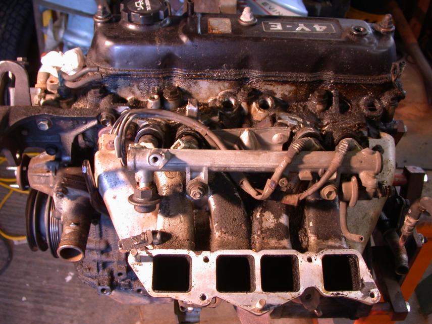

Here's the transplant 4y with the manifolds bolted (and torqued!), tons of carbon removed and ready for Toyota to call me with that parts order! *note the "clipped" wires to #3 & 4... ugghh.
Attachment 348

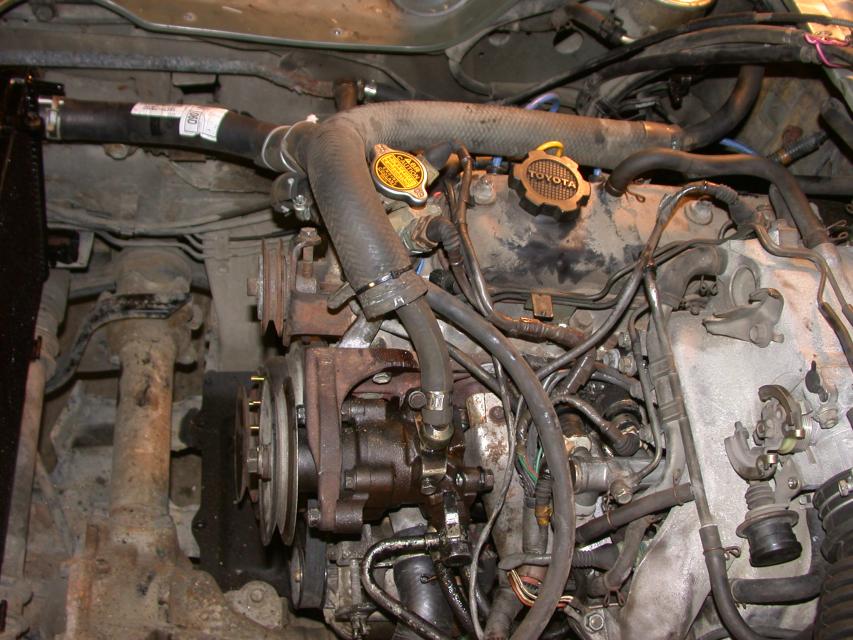

Found one custom mod that you might like, check out the lower radiator hose sheath over the power steering pump line: Was looking for something to protect it and almost cut it up, now I carry a spare everyplace I go!
Attachment 350

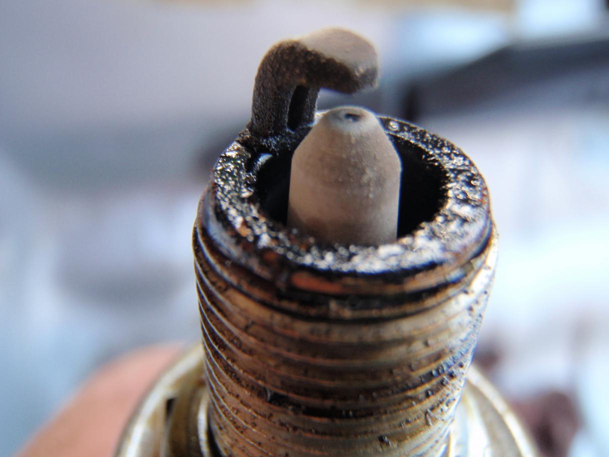

Tim, van ran perfectly for the first week. Then, while driving to Neah Bay, it started to sputter and miss off and on. Still runs okay, just really rough now. Took the plugs out today to have a look and they are all quite oily but not fouled- oil all up the threads.
Attachment 363
Removed cap and rotor, cleaned them up too, ran a bit better after this operation. The cap, rotor and wires are not new but were replaced last summer so I ran them anyway. :wall: AAARRRRGGGHHHH!!!!
Maybe needs hotter plugs or ignition issue? It ran similar to this before the swap, spent much $ trying to smooth it out, then determined the head gasket to be kaput. Nearly back where I started last fall, except this motor is really smooth despite the chronic miss.
Think I will just get the new cap, rotor, plugs, wires and some good injector cleaner. Dislike throwing money at problems, would rather go to the casino and try my luck. :(:
