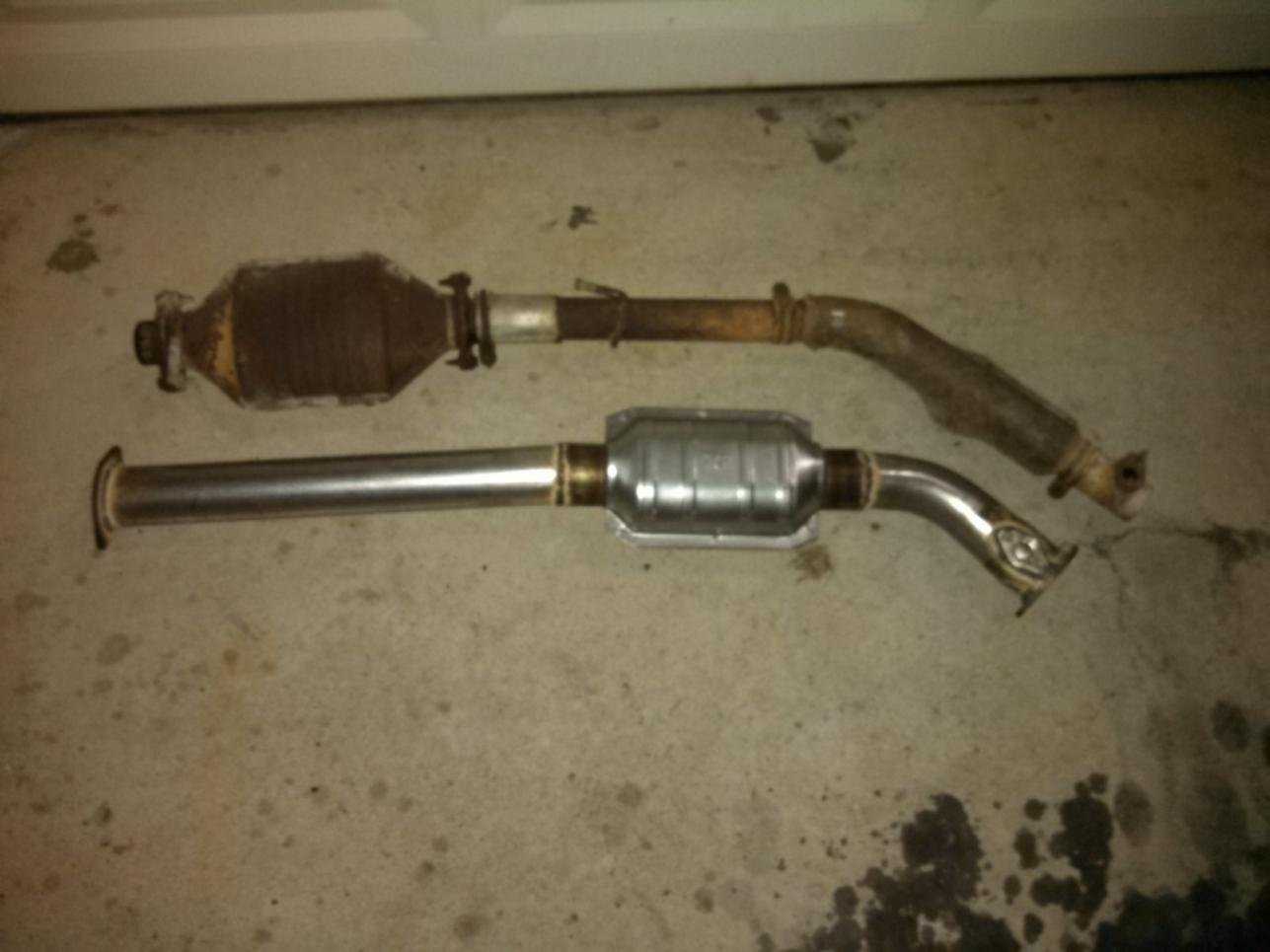

Here is the new exhaust. I cut the header as close to the y pipe as possibl, adapted from 2" to 2.5", moved the cat forward 19"and maintained 2.5" to the rear axel, them necked back down to 2". Summit had everything for $160. It took 3 hours for me to fab in 15*f weather. Not bad.
Attachment 1214
I have always felt the cat was too far rearward to receive hot gases. New cars literally have them wrapped around the motor.
I have maintained 2" clearance to the battery. And 1" to the transfer case. Heat shielding may be considered in the future. I'm not worried with the current temps.
Driving to work today it is noticeably quieter on the hi way. The glass pack muffler I already had in place was a little louder than preferable.

The moral of my story is its amazing what a new Catalytic Converter can take out of emissions. I should have done this first.

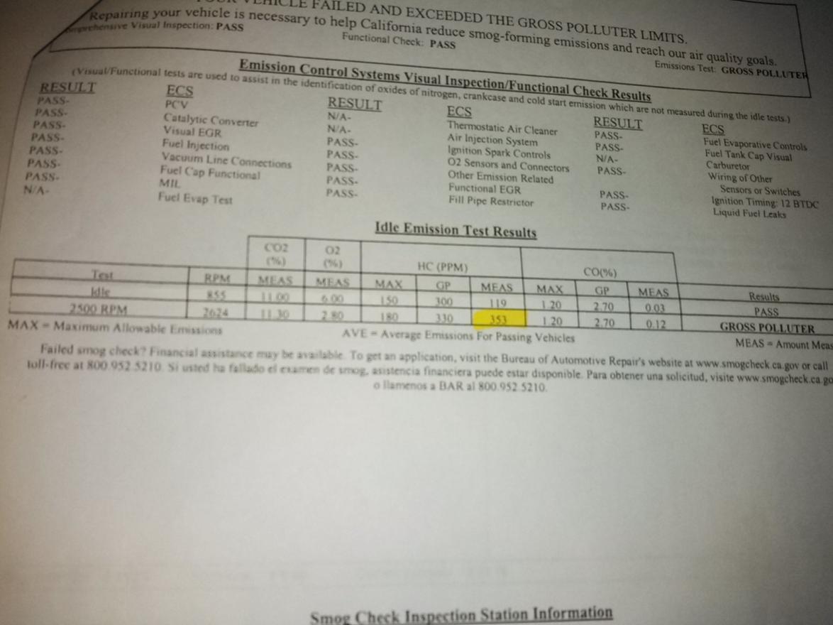

Back in November I failed smog with High CO and HCs Idle and 2500 RPM. I was basically double the limits.
Things that needed repair were the EGR and O2 sensor.
Next Test:
Attachment 1239
Passed Idle emissions, Failed HC at 2500 rpm. Still a gross polluter.

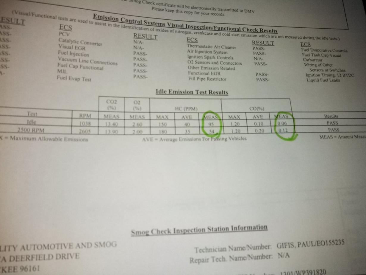

Installed new cat:
Next Test
Attachment 1238
Passed with flying colors!!!

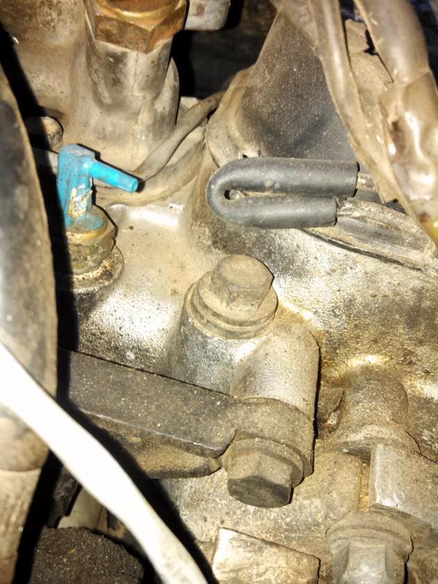

:whs:. Always check codes 1st. Failed EGR operation is the most common cause of high NOx. On the van, it's likely you have a broken BVSV (Bimetal Vacuum Switching Valve). If the nipples are broken off, a temporary fix can be to bypass using a short piece of vacuum line. The 1st picture shows location, the 2nd picture shows one that's bypassed. If yours is broken and if you bypass, make sure the vacuum hose can make the turn without kinking. The one in the 2nd picture is kinked or on the verge of kinking. If the hose kinks, it will not allow EGR operation. Tim

I just went to check my BVSV .. and while I'm not sure it was actually leaking until I touched it.. it snapped right off, you weren't kidding about them getting brittle :doh:
So is it ok to bypass it as shown in this thread? I am assuming it only means that the EGR will operate white the engine is cold as well as once warmed up .. any downside to this bypass? or should I spend the 40 bucks on a new one????
