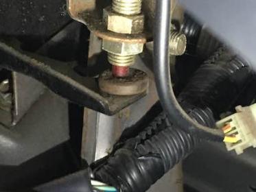

So, I poked my head underneath the brake pedal (good thing I'm flexible!) and I think I found the brake switch and cushion..
The cushion has a little dent in it, but not much.. however, it did seem like the brake switch wasn't being pushed all the way back up unless I lifted the brake pedal by force (which is what I've been doing with my foot).
Is it possible there's also an electrical issue connected to the switch?
It was a little gunky, so I sprayed a little lubricant on the switch and it seemed to move a bit better.
(this photo was taken while depressing the brake pedal with my hand, so I could get a clear shot of the switch/cushion)
Attachment 5031

Looks like you found it.
While the dent doesn't seem like much, its obviously enough to be causing the issue.
You need to clean everything well and verify that the switch moves freely and that the pad is not contaminated by brake fluid, causing it to soften.
-If you look further up the brake pedal arm, you will see the master cylinder push rod that attaches to the brake pedal.
Sometimes a leaky master will dribble brake fluid down the pushrod, onto the brake pedal arm and run down, softening any rubber it meets along the way and cause dirt to be attracted to the switch.
The switch is mounted in a bracket with 2 jamb nuts to allow for final adjustment, usually things set at the factory shouldn't be messed with but in this case, assuming no leaks are found and the pad isn't contaminated, I would be tempted to adjust the switch forward to take up the slack thats causing the switch to stay on.
You want to use 2 open end wrenches I think they are 12mm nuts, but could be 14mm. Hold the forward nut and crack the back nut loose, back off the rear nut, maybe a 1/4-1/2 turn, then, while holding the switch steady, finger tighten the forward nut, this will move the switch forward, once you find the right place, make sure to tighten the jamb nuts (tighten the rear nut, while holding steady the forward nut)
Don't go too far, just enough to shut the lights when the pedal hits home and please verify that the brake lights actually come on with light pressure on the pedal BEFORE going for a test drive.
