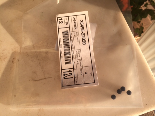

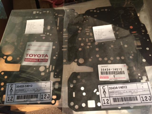

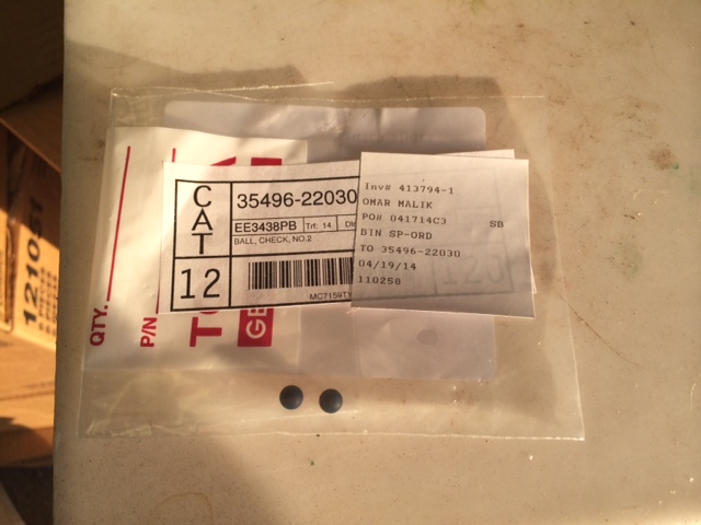

I just got all the parts for the job in yesterday. Hopefully it will work out for me. I got a total of 6 rubber check balls. 4 smaller ones and 2 larger ones.
Apparently 2 Larger ones and 1 small one belong in the lower valve body while the other 3 smaller ones belong in the upper valve body.
Please let me know if I am missing something for the job as the diagram at the dealer was confusing to me.

mahleek87,
Just refer back to the repair manual pages that you posted earlier. It looks like the same ones that I referred to when doing my repair. Those drawings indicated where the balls go and using that information I was able to get the balls back in place and the tranny working properly.
