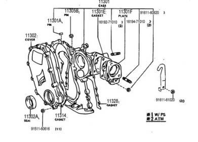

I was just about finished replacing my thermostat when I snapped off the lower stud. Wondering the best way to proceed here. Anybody know if it is threaded and could be dealt with similar to the exhaust manifold studs? Seems like it might be cast into its home, maybe I could drill it out and tap it for a bolt? Third option I have been thinking is replace the whole part, am I correct in thinking this is the water pump housing? Any guidance much appreciated.

Edit: I think I just answered my own question, but maybe my post will help another unfortunate soul. Found this picture of the "Timing Gear Cover and Rear End Plate". Looks like the studs are threaded, so I guess that is good news? I think I am going to be down in that hole for a long time.

It's a steel stud (Toyota part #16194-71010) that's threaded into the aluminum timing gear case. It looks like there's enough of it sticking out to give you a fair chance of easy removal. If I were in that spot I'd apply heat to the stud (carefully avoiding direct heat to the aluminum housing). I'd use an acetylene torch with a focused tip and get the stud glowing red, then wait for it to lose the red glow and immediately try to remove it with a vice grip (while it's still hot).
These studs were put in tight with some sealant and/or Locktite type material on the threads. Heat applied correctly to the stud will weaken that bond and the expansion/retraction of the steel & aluminum should allow for easy removal. As always, when using a torch, do so in a well ventilated area. Be very careful when using an open flame around fuel lines and make sure there's no gasoline or other flammables in the immediate area. Also make sure you have the proper type fire extinguisher handy. If you're not comfortable doing this yourself, call your local parts store and/or weld shop and ask if they know of a local guy who extracts broken bolts/studs. There's usually a mobile guy in most areas who will come to your location and is capable of some amazing things. Good luck. Tim
PS: I'd take that spacer plate off before attempting stud removal.
