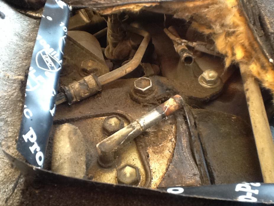

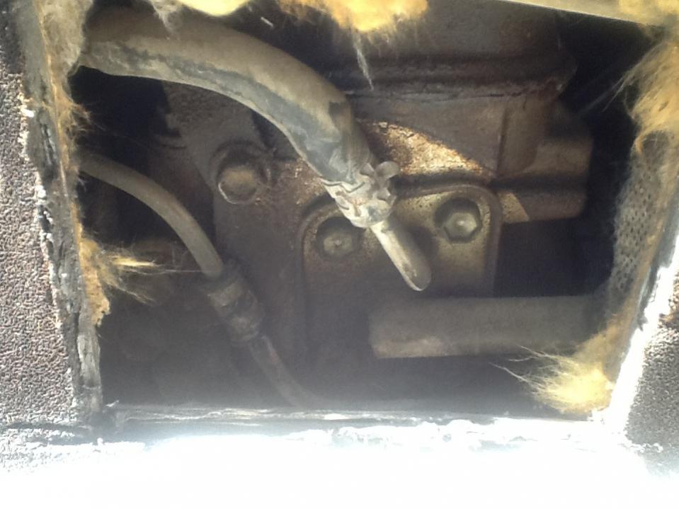

This is the second time I have replaced the "hose of death" since I bought my 1984 Toyota Van new.
I was going to cut an access hole as described above until I remembered that I had placed the two clamps in a position so that I could reach
them from underneath the vehicle with a long 1/4 inch extension. They came right off.
The hose was hardened, so it broke apart pretty easily thus being pretty easy to remove. I had removed the EGR valve in order to get better access
from the driver's side.

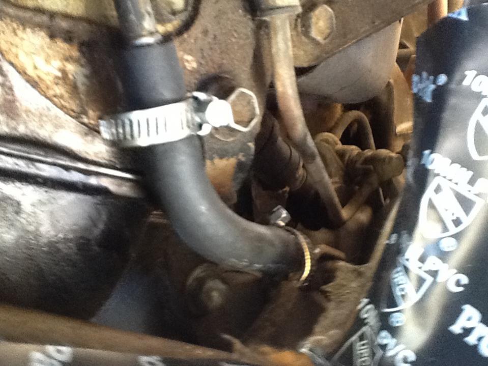

I thought about getting the Gates hose that Tim mentioned above, but instead decided to get Silicone Heater Hose which has
a temperature range of -65 F to 350 F. I bought VMS 5/16 inch silicone heater hose. Part Number VMSHSE1P-031-BLK
Nice and pliable and easy to clamp.
http://www.verociousmotorsports.com/...ld-by-the-Foot
I attached the hose with the clamp on it from the driver's side first, rotated the clamp so I could reach it from underneath. Then I
tightened it on that side with the 1/4 inch extension and socket from underneath. I then went over to the passenger side and bent the hose
with the clamp on it so that I could slip it over the passenger side nipple behind the valve cover and then rotated the clamp so that I could tighten it from underneath and it was done.

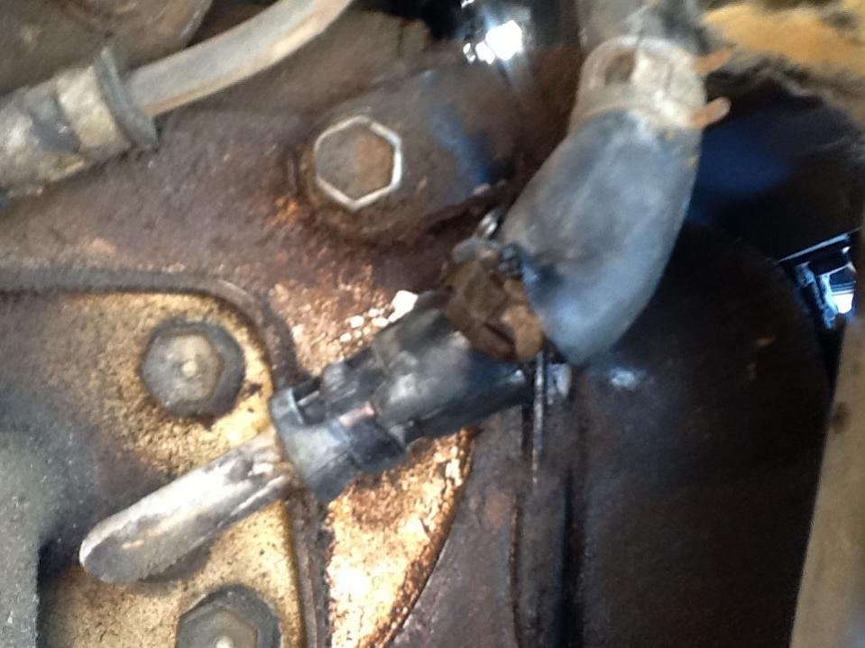

Hello All,
This morning as I was parking my van at work I could smell evaporating coolant. I looked under the van and it was spraying coolant all over the parking lot.:(:.
A first I thought the head gasket blew, but on closer inspection it looked like it was spraying out of the side of a hose. (Please see the number marked 1 on image. Hope you don't mind me using that image). I think the metal pipe next to it melted through the coolant hose.
Attachment 2619
What size hose should I use to replace it? Also I notice that clamps are used, should I do this as well?
Also, while under there I notice the bolt that attaches to the intake manifold missing (2).

Well this is not specifically the hose of death, but related i guess.
It was as I suspected. The hose was melted by the EGR metal tube. Melted right through it. I was able to pick up some 5/8 heater hose rated for +350' F / 60 PSI and two new clamps at NAPA. Removed and installed all during lunch hour.:dance2:
Hopefully that solves the problem.
Re: The hose of death thread
That should solve it. These hoses get fragile when they get old. If the EGR is getting hotter than it should, that's a sign of a failing cat converter or the timing being off. It could also be a problem with your electronic advance............or could simply be a poorly routed hose. Just thought I'd throw some other possibilities out there as food for thought. Tim
Thanks Tim!
-I have got to hand it to you. You are always one step ahead of things. Getting the timing checked is on the list. My initial thought was, it was to close to the EGR. But as I replacing the hose, I started thinking. Why? Is the EGR suppose to be running that hot?
Thank you again for your help and TV wisdom!
-Ian

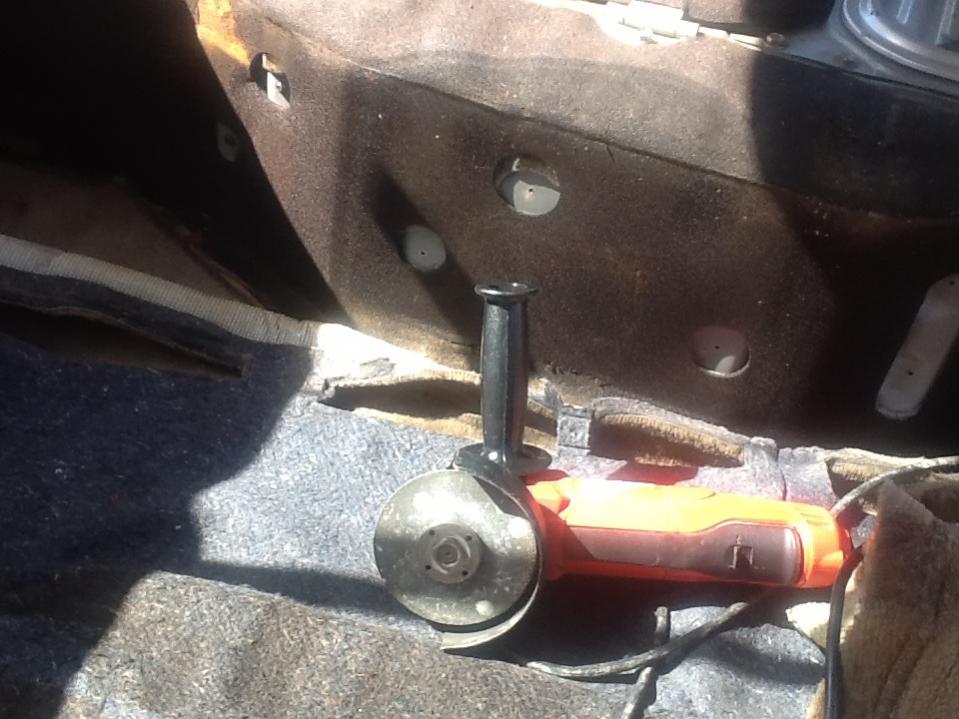

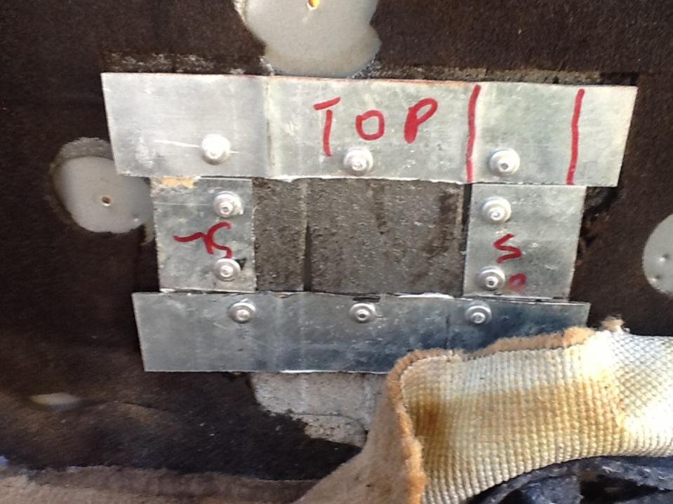

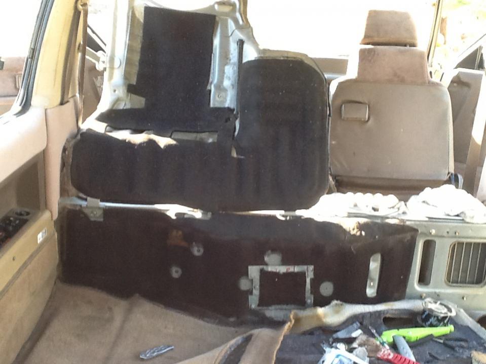

Must just be that time of year lol, im about to cut an access panel myself. I am going to lay some sheets of leather i have all around the hump, and use my air cutoff tool to cut the size hole i need. I was looking at nice hole saws but 80 bucks for the 8 inch is just not happening.

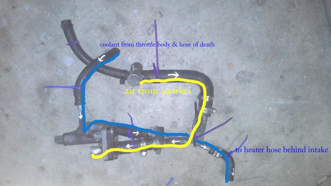

Do I have these coolant and air flow directions right?
Attachment 4674
Looks correct to me. :thmbup:
So hot coolant (which may contain bubbles / steam) from the Head / HOD has to flow downhill and then into the block to get reheated, AND NOT GIVEN A CHANCE TO COOL???!!!
http://i1360.photobucket.com/albums/...ps8d078a0d.jpg
In 30 years am I the first one to realize this?
The tube that goes to the block runs up to the front near the water pump???
If that is true it will cause the pump to cavitate air???
