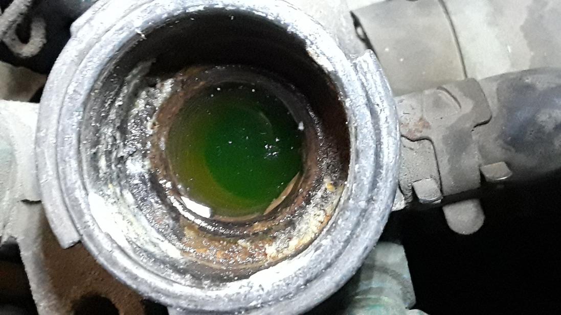

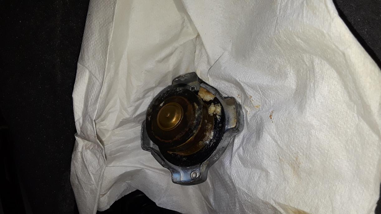

Apologies in advance for necromancying this thread, but I've recently got a concern about my cooling system, and about time too. Today I was just adding oil per usual, added too much so I'll have to sort that out :/ ,and out of boredom I took off my cooling junction cap and saw THIS!
Attachment 11966
I have very, very slim knowledge about cooling systems in general but given the almost rotting fish smell, and obvious soft buildup in the cap and the area in here
Attachment 11967
Something is definetly up!
Given the mostly previous unknown history this would be an ideal thing to do since I am keeping this thing. What would be the best course of action now? Drain &refill, flush, some sort of Prestone flush/clean additives or some thing other to do with the system? Any info is appreciated.
Thanks again in advance TVTPeople!
Re: Full coolant flush tips?
Over time coolant gets acidic and will start eating the aluminum parts that are exposed to the coolant. A translucent white "gel" and/or white powder is a by-product of that corrosion process (and that's what those chunks look like to me). If you get a high quality coolant (like Prestone premixed 50/50) you can go up to 5 years and 50k miles. I always hit 50k miles in about 3½ years, so I change my coolant every 3 years.
If yours is older than 5 years/50k miles or if you don't know, replace it. You can also get "test strips" at most auto parts stores that will show acidity levels in coolant, but based on that picture I'd say it's way over due. I recommend draining from both the radiator and the block drains, then flushing and refilling with the Prestone 50/50 pre-mixed. If you opt for the concentrate, be sure to mix it with distilled water. Tim
