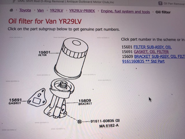

Hey Burnboot:
OK, well I did not have to take off the that piece but you were spot on. I was able to get around it to see the leak was coming from the oil filter housing where it mounts on to the block.Coming right out of the bolt there. I cannot seem to find anyone who even knows what this gasket/O ring is. There is nothing on the site about it. So I guess I will have to take it out and see what it is and punt. If you know anything about it let me know.
Thanks again for all the help.

Like this?

hmmm, pic didnt come with :(
Attachment 11388
That seemed to work tho
Re: Oil Pan Removal and Re-installation
That's it!!
So it is a gasket and not an o ring.
Looks like I will have to go to Toyota and get it.
Thanks. will keep you posted

Hey Burnboot:
Well this gasket is nowhere to be found. Toyota cannot even give me a clue on when they can have one. My only idea is to make one. Have any thoughts on this? I check the site for this and found nothing. I will at least post a new message to the group to see if anyone has any idea how to solve this.
Again, thanks for your help on this issue
At this point, it may only be available as part of a set (lower engine set maybe??), if at all.
That gasket is very simple and I would not hesitate to make a new one.
As long as you use proper gasket material (most parts stores will carry something) you should be fine.
