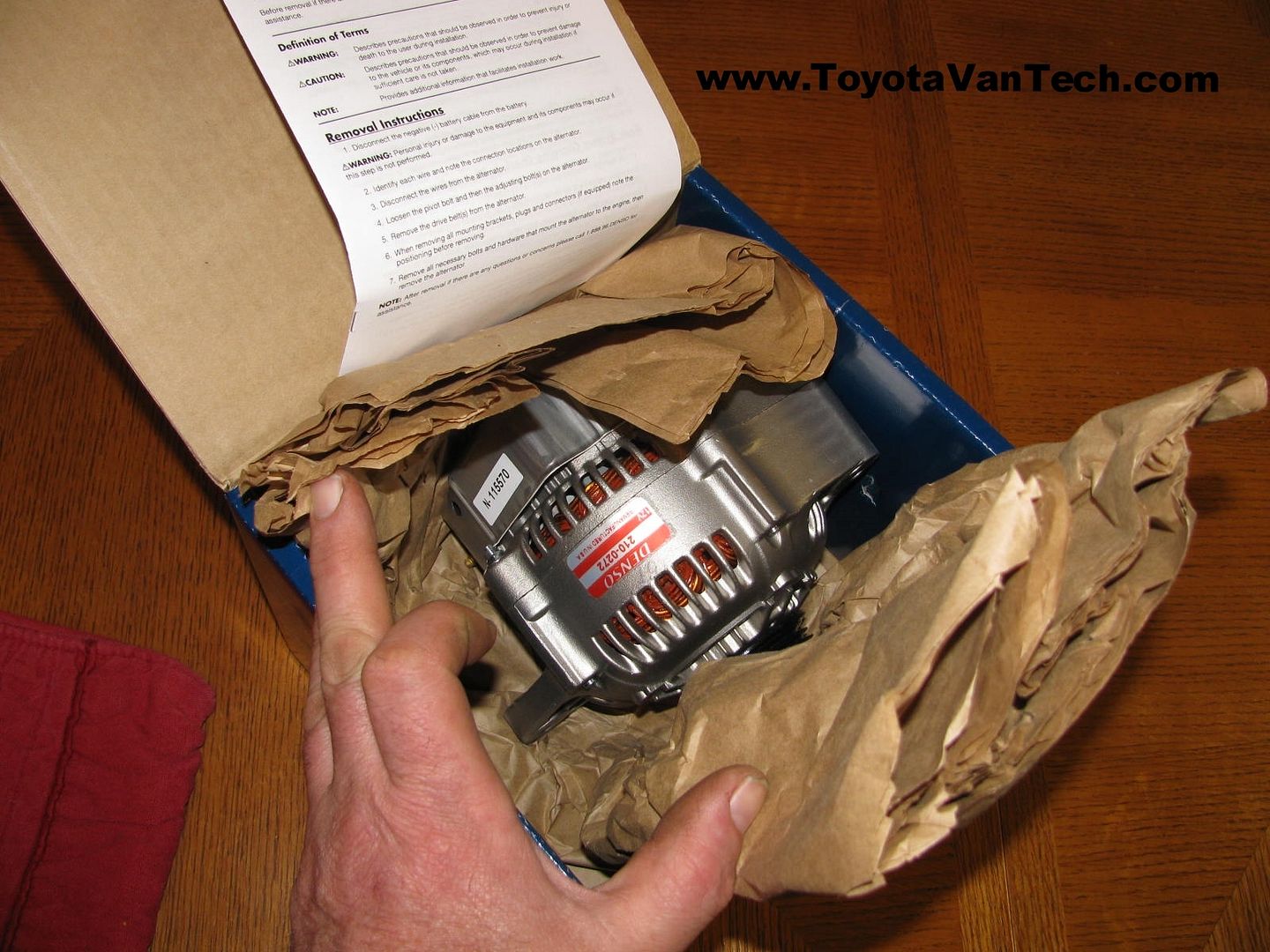

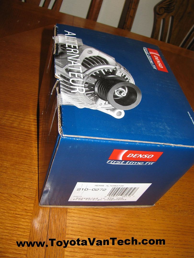

:clap: Yay!!! alternator finally arrived!!! And yes, it's actually a genuine Denso rebuild. So, if you can wait 85 days to get, CarID isn't a bad place to order from (or wasn't.........now you have an additional $34 core charge) :swear: . Tim

i just ordered a rebuilt Denso alternator but I typed in Denso # 210-0272 and it said it didn't fit and that Denso # 210-0115 is the proper one for the Van. :?: They haven't shipped it yet so I can still cancel the order if it's the wrong one.
http://www.amazon.com/gp/product/B00...?ie=UTF8&psc=1
UPDATE-
looks like 210-0272 is for the 89' Van and 210-0115 is for 87'-88' vans. But since they all have the 4y motor they both should fit I'm thinking?
I'm gonna order the 210-0272 since theres one left.
oh better order it before it's gone:LOL2:
Re: dead alternator: buying parts to repair it or buying a good rebuild (Denso)?
Either one will fit. The 210-0115 is just slightly less output than the 210-0272. IMO this makes no difference as it's hard to imagine ever overloading either one of them (unless you're doing something like driving a 500 W or bigger amplifier at full volume for long periods). If you pushed either one to sustained full output, the 210-0272 would probably self destruct faster than the 210-0115.
