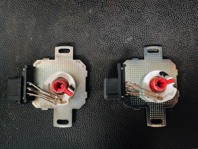

I put a bunch of freeway and city miles on the van over the weekend and made it home with no hiccups or engine codes so I'm going to tentatively call this fixed. Thanks again, Tim, you truly are the man! A postmortem on the TPS showed a fair bit of corrosion on the connector prongs. I probably could have gotten away with simply cleaning the connector and the prongs on the TPS and reinstalling but I had already passed the point of no return when I saw this.
Side note, my Rockauto replacement TPS arrived with the tabs broken on the black plastic box and I had to swap the box over from my bad one. I'd never actually seen what the inside of a TPS looked like, it's surprisingly pretty straightforward. I wonder if these can be serviced in the future once replacement parts dry up and/or become prohibitively expensive.
