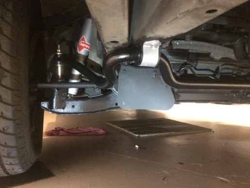

regarding stabilizer bar bushings---you can get great Rock Auto deals on bushings and end links......pay attention to 2WD vs. 4WD ...additionally, use cooking oil in the bushings not motor oil ... the fit should be nice and snug, and, when the frame bushings are worn out, ... it can be a source of "clunking".Attachment 6770
