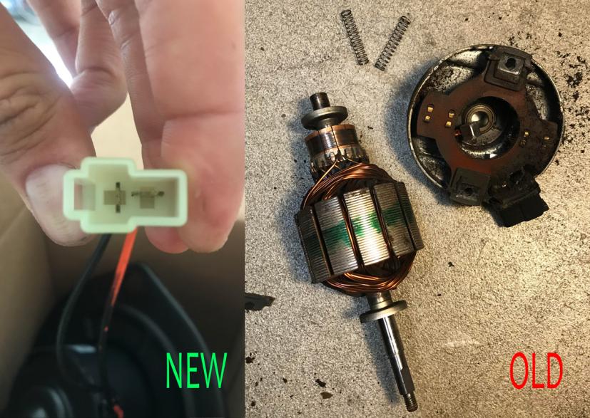

Sounds like your brushes may be worn. Sometimes when they are bounced around they make enough contact to get the motor to work. Mine did this for awhile too like yours and when I moved the fresh air flap sometimes it would come on. When that quit working I carefully poked it with a coat hanger from behind the headlight to push start it. Eventually it quit all together. I replaced the brushes on mine but I like fixing things like this. If soldering new brushes into an old motor isn't your thing the aftermarket motors aren't all that expensive. Resetting the circuit breaker won't help you here. If it had actually tripped, the motor wouldn't work at all. The breakers don't reset themselves. Since your glovebox is out, next time it doesn't come on test the voltage at the fan connector. If you've got voltage then your motor is bad.

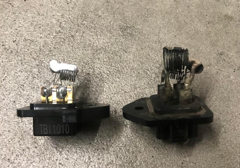

Yes, these fan resistors are a commonly failed part. Power is however only routed through the resistor when on the lower speeds. When set to high, this resistor is bypassed. This is the reason I suggested setting the fan to high while testing (just to rule out the resistor). You do bring up a good point though for anybody having a problem with lower fan speeds. Whenever your fan works on high, but not on a lower speed, the problem is almost always that resistor. Tim

Glad I found this thread! Ever since I got my van the two low speed blower settings didn't work. Just installed a new resistor and they work perfectly now! Love it when a fix is easy. Thanks TVT!:clap:

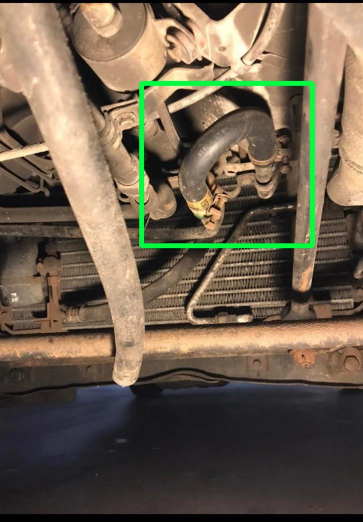

I would like to mention I have the van for almost 2 years without front/rear heater and the old owner had a loop hose, so it wasn't connected to the heater at all. (I have connected the hoses with the heater).
Attachment 10654

2. I replaced my resistor and motor with new ones. (both were in a bad shape)

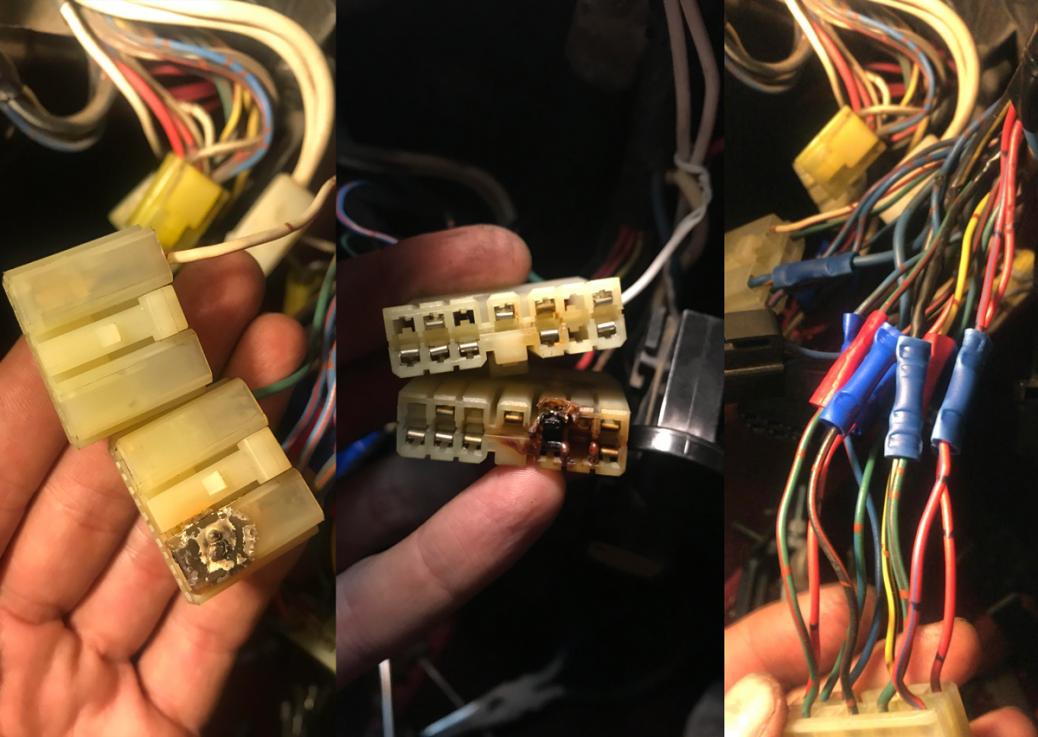

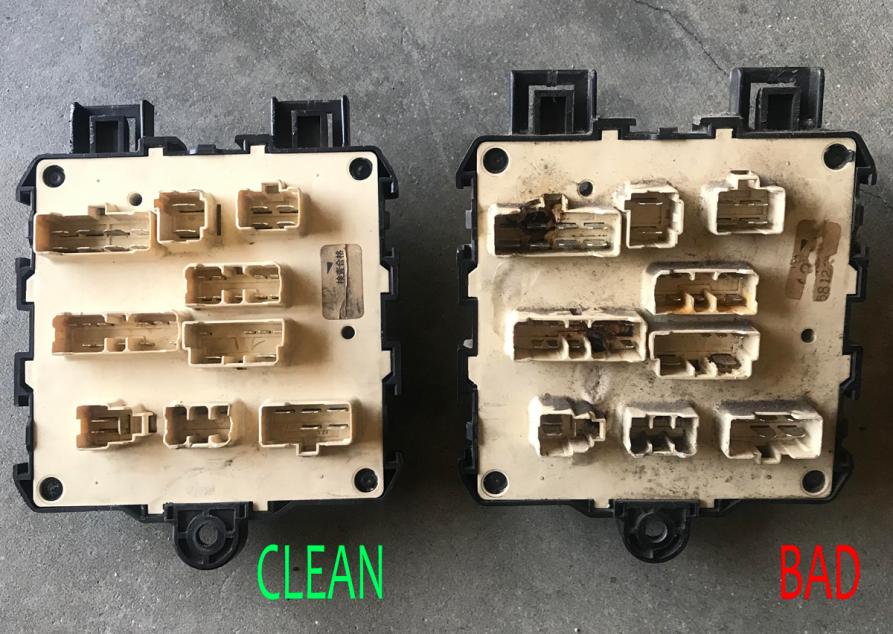

3. I replaced my bad old fuse box and 3 bad connections with clean ones.
Attachment 10660
Attachment 10661

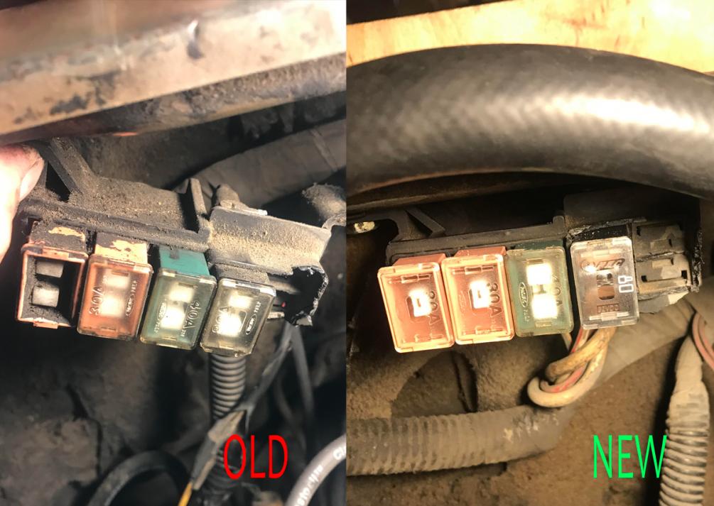

6. After trying everything above, I bought from Toyota dealership 2 30A and the 80A Fuses and replaced them in my Fusible Link.
Attachment 10662

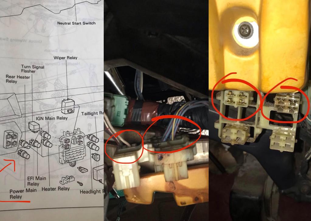

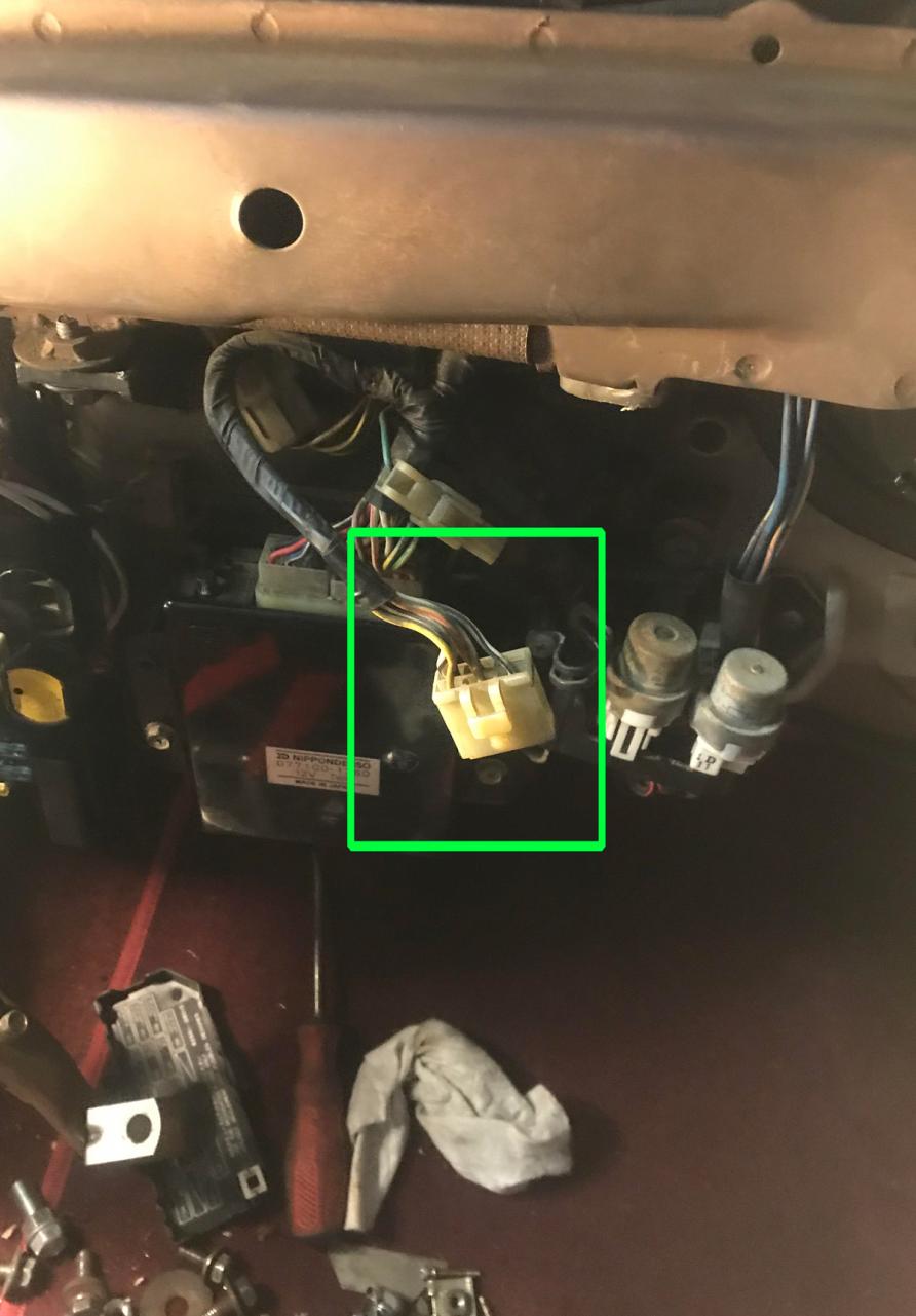

Something else I have noticed under my van’s steering wheel, I have 2 relays and the diagram has 3 relays. But I have asked other Van owner and some of them have 2 relays as well.
Attachment 10653
Also I have this guy is not plugged anywhere, what is it?
Attachment 10655
