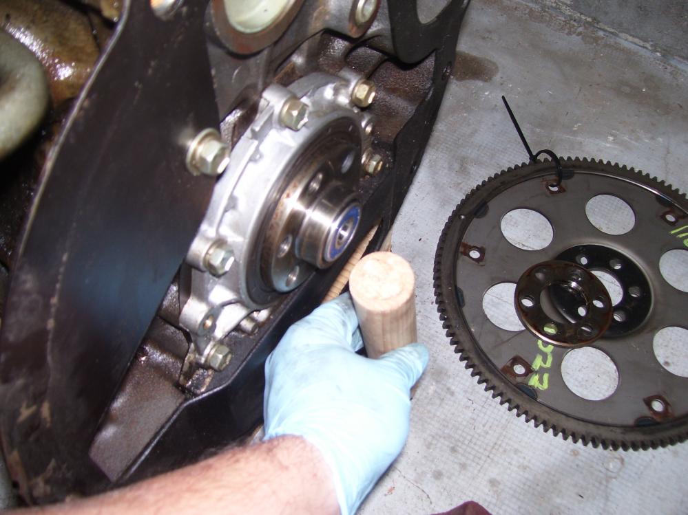

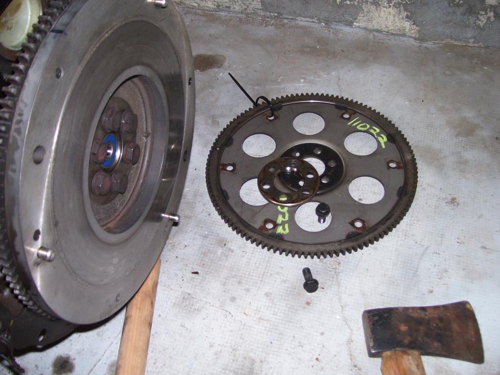

Making a bit of progress while I await my delivery of electrical injector connectors and other parts: I removed the clutch and flywheel from my old motor and swapped the flywheel onto the newer motor- My first clutch job! The flywheels use different bolts(bigger on the manual) and the auto has a couple extra spacers but it's pretty easy to figure out.
And I hammered the pilot bearing into the hole-using a 1-1/4" wood dowel that just happened to be sitting on my garage floor and fit the job perfectly-with a tiny bit of drilling out the inside so the force was focused to the outside of the bearing.
One question: Is there a torque spec for the flywheel? I didn't see one in the manual, so do I just use the impact to torque the 6, 17mm bolts down? There is a spec for torque-ing down the clutch disc and cover but that was it.
Here's a pic of my new pilot bearing half-way installed with my DOWEL, THE INSTALLER, and the auto-flywheel is laying on the ground with it's spacers.Attachment 360
And this next pic is with the manual flywheel installed:lol: and the auto flywheel on the ground, feeling neglected:cry:.Attachment 361
Re: replacing engine, need help
Looking good! The flywheel to crankshaft bolts torque spec is 61 ft lbs. The pressure plate bolts are 14 ft lbs. Tim
