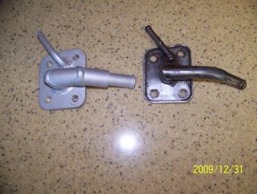

Sorry, also forgot to mention: Back in the day when I was having a terrible time trying to figure out where my coolant
was going (similar problem to yours) my mechanic was doing the "hose of death" project and discovered that the coolant outlet plate (on the back of the engine which is attached to the hose of death) was corroded and had tons of tiny pinholes in it. So the theory is that while hot and under pressure, the coolant was being forced out the pinholes and evaporating on the rear of the engine leaving no visible sign of a leak.
Something to check if you have no luck elsewhere.
