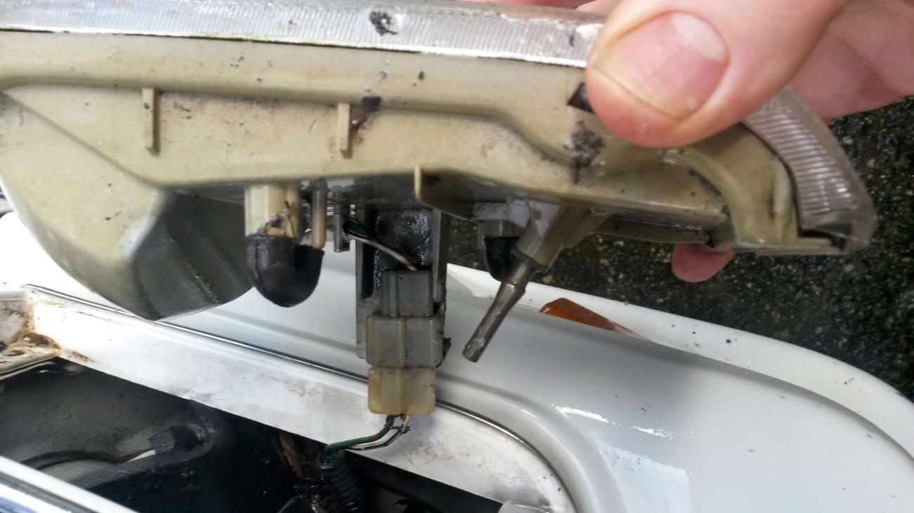

Assuming you are talking about the one next to the headlight as opposed to the one mounted lower down in the bumper:
After undoing two long stainless screws at the rear, they come out forwards at about 60 degrees from a line pointing forwards.
it has a round pin that clips into a socket. they can be stiff so take it easy.
Attachment 11212
Re: Cornering Lamp Removal
Yes, the ones mounted on the outside of the headlamps. Still confused by "they come out forwards at about 60 degrees from a line pointing forwards." though, I'm not sure I get what you mean by that. I'll watch out for that clip though. :thmbup:
Yeah I mashed that a bit. delete the first 'forwards'.
you only have to look at the angle of the locator pin on the back side of the indicator to visualise what I meant.

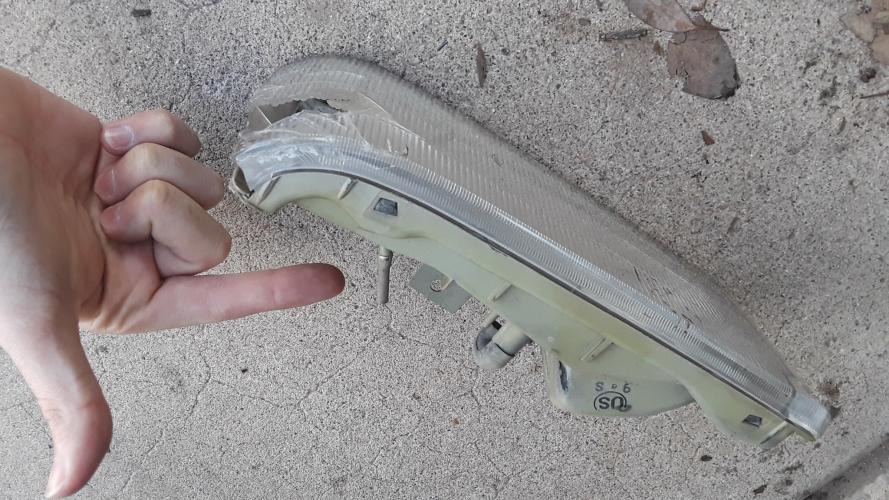

Re: How the heck do you remove front corner lights w/o damaging?
Thank you oh so much for this write up, the visualization of the peg at a 45 degree angle aimed at the drivers seat helped out a lot. Was a bit stubborn but guess what!Attachment 11908
Got it with the peg out attached!!!
My cornering lamps dont have bulbs so it's more of a showpiece thing, lenses are busted in both at the front so all sorts of crap was in there. Now I can examine my headlights! :dance2:
Might even glue back two pieces of the lens that fit back into where I think they go, gotta clean them out first though.
Thanks again Carbonized!
