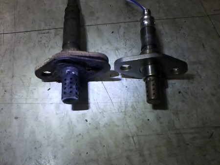

Just ordered and received o2 sensors off sparkplugs.com , for my 88 LE 4wd. Wanted to double check I ordered correctly? As the new sensors are a little smaller than the old ones pulled out. Actually I'm only comparing the upstream sensor at the moment as the rear downstream sensor nuts are rusted and rounded and i'm stuck trying to get them off.. ug.

Denso sensors are smaller than Bosch, so perhaps that's what's in there now? As long as the studs line up with the holes you should be good. Tim

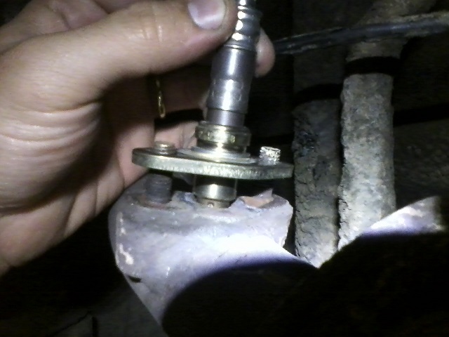

Going bonkers. Cursing and hacking I finally got the rusted stripped nut off the rear o2 sensor bolt.. took some work but the sensor finally came out. Go to slip the new one in and it doesn't fit. The one upstream fit fine... I'm about to just cut the rear tail pipe off I've had it :anger:...do i even need the downstream o2 sensor? ha.....
perhaps the downstream sensor mount is not original? Not sure what to do.. Maybe drill out the hole in the mount to fit new sensor? hmmmm
That was my experience with the upstream sensor as well when comparing it to the (I assume original) one that came off of the van. I just chalked it up to minor improvements made in the past 26+ years. My new upstream is working fine and throwing no codes so I wouldn't worry about the minor changes.
That sounds like me last month with the cursing and hacking :anger:. That is strange that the new sensor doesn't fit, maybe there is residual gasket material/junk on the edges of the hole that is blocking installation of the new one? I don't imagine that's the case though (worth a shot). I don't see how drilling out the hole would hurt but getting a drill to it might be hard with all the angles and where it's located.

Yeah at first I thought it might be gunked up.. but its not. It definitely does not fit. It is a little tight to get a drill in there to try and drill out the hole. Kinda stumped at this point. I may need to find a different sensor that will fit.
Upon closer inspection of the old removed ones, they are marked as Toyota sensors. Which makes me think the rear mounting is original and not modified...

Was able to drill out hole a little larger to fit the sensor. How important is it to a have a good seal between exhaust mount, gasket and sensor flange? After tightened down it looks like there is a little bit of gap between. I was afraid to tighten too much for risk of breaking the already abused mounting bolt...
I would imagine that its fairly important. If there is not a good seal between all parts the van will likely sound a little worse, as its essentially an exhaust leak. Outside air getting into the area might mess with the voltage that the downstream sensor reads as well. It obviously doesn't need to be torqued down, but hopefully you can get enough on the bolts so that it makes a nice tight seal.

Thx, that was my thought. Seems to be running fine with no more code, even w/o as good of a seal as I would really like. Guess it be on my list to eventually revisit and possibly weld new mount.

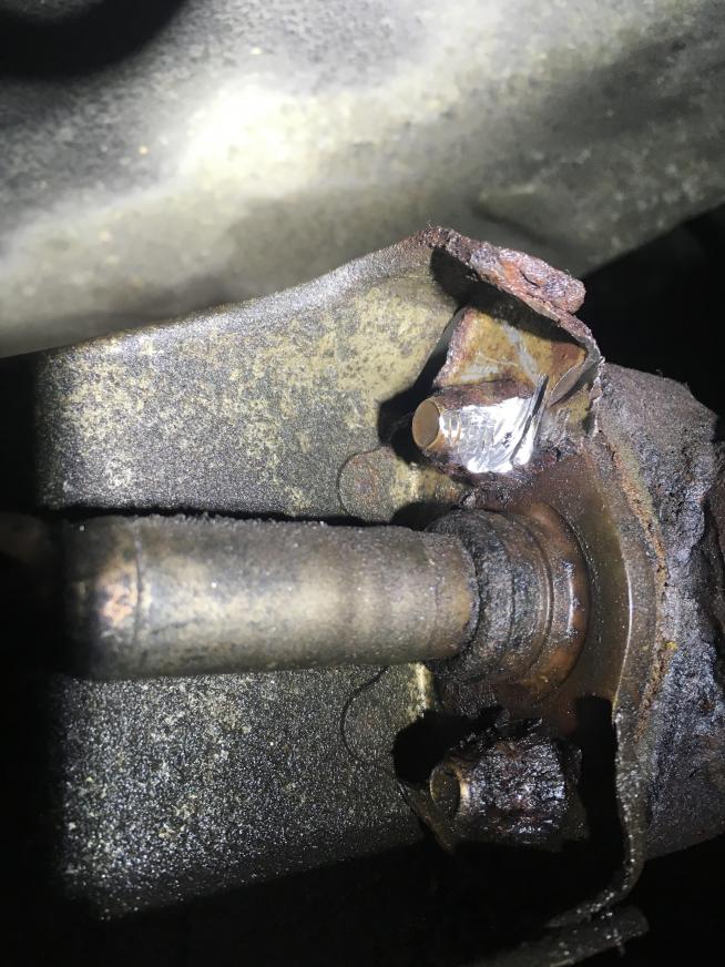

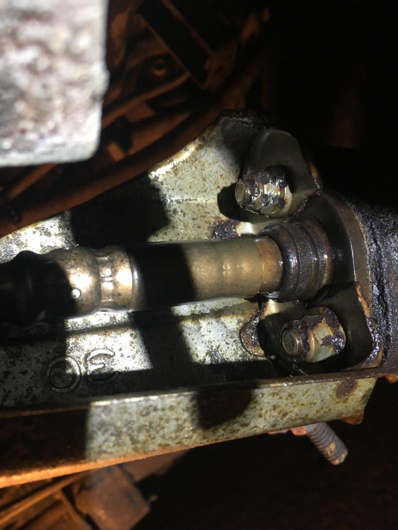

I'm going through a similar saga with the nuts on oxygen sensors being rusted and rounded. The downstream sensor is definitely the worst, but both are bad enough that a socket won't fit on them and there is just not room there to get most of my tools in! What ended up working for you guys? Any tips or tricks. I don't know if all vans have these splash guard things on them but they make the whole situation pretty tight.
I (maybe stupidly) tried to cut into one of the nuts on the downstream sensor because I thought it might be rusted enough to just break open easily. It hasn't yet though. May not be using the right tool (Dremel) and can't really get to the nut from another angle with this.
Ready to go crazy so any help would be much appreciated!

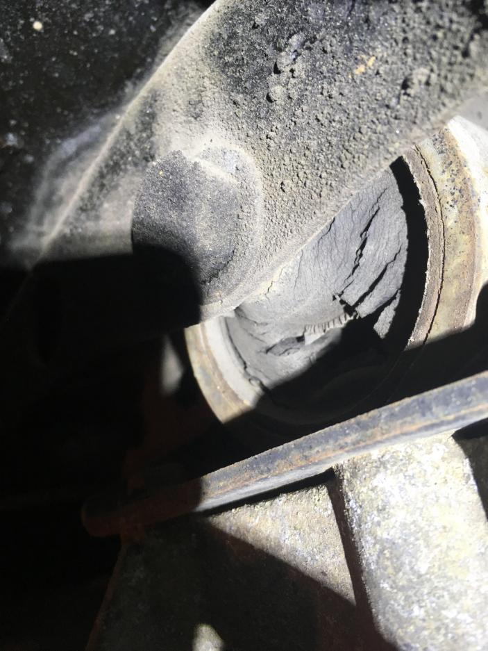

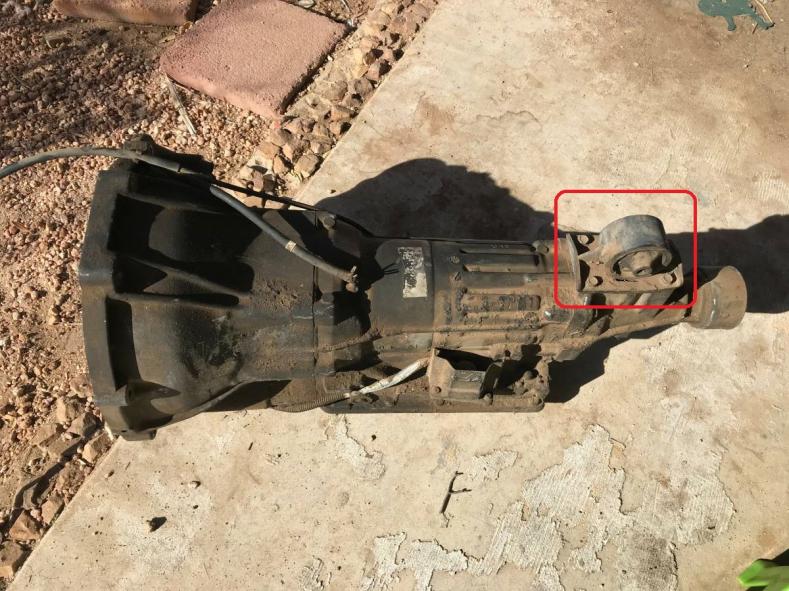

The last picture isn't an oxygen sensor obviously but something I saw while down there above the oil pan and was wondering what it was if anybody knows.

I ended up cutting out that shield as I couldn't get any access either. I figured a new shield would be easy enough to fab with some scrap metal if need be, but am not running any kind of shield as I live in the southwest and it rarely rains. I suppose the shield would also block rocks and other debris, but :?:
Once I cut out the shield I had plenty of access but the nuts were all rusted to hell. It still took a few more hours of PBlaster, yelling, cursing, and a pair of vice grips before I could get the bolts free.
As for that last picture, I believe that's the rear transmission mount (see below)

Thanks for pointing this out, I went out to look at mine after looking at this thread and the whole bottom half of the mount has eroded away to nothing, like I could stick my finger in it and slide it around the whole bottom half of the mount, which I'm pretty sure isn't right or safe. I'll be tackling this imminently once I finish my current project (rebuilding the drums :pissed:).
