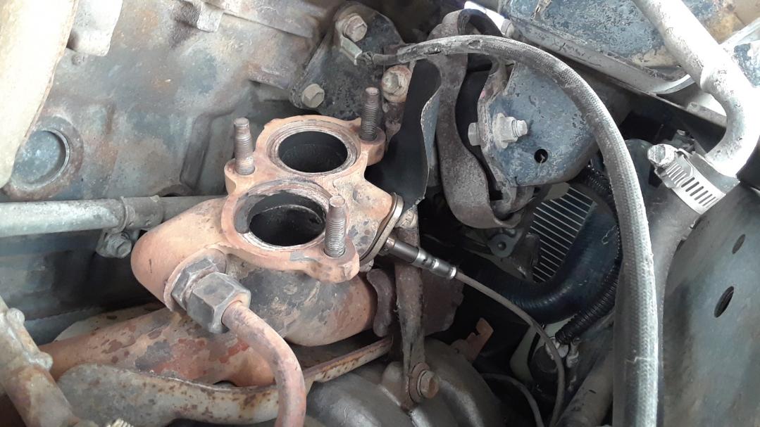

doing some exhaust work, a while back when i replaced my O2 sensor i moved it from further down the pipe to the boss directly on the exhaust manifold...van has been running fine, but i will be having the exhaust redone from the manifold back and was wondering if this position is ok or i should replace the bung further down the pipe...are any of you running the O2 directly in the manifold?Attachment 6829
The 87 -89 AT 2WD/4WD Vans have the upstream(just one on the 87) 02 sensor further down on the pipe as shown. 88-89 have the upstream and down stream heated sensors 4 and 2 wire respectively) For some reason on the 84-87 van with MT the 02 sensor is mounted on the exhaust manifold . 84-86 Vans MT and AT have the 02 mounted on the exhaust manifold also
So I think you are fine to move it down
Attachment 6840
actually i want to keep it in the manifold if theres no bad reason to leave it...my collector pipe has seen better days and theres not much meat after the 02 bung for welding new pipe, so i was gonna have the exhaust guy start in front of the.bung..i guess i can add one later if issues arise..
I've run both in the manifold and after on my 87 MT 4wd. I like in the manifold best. It allows the unheated o2 to heat up faster, and stay hot longer during idle. Other than the fact that it is more difficult to replace I have experienced no issues running the o2 in the maifold.
With the turbo I run a heated o2 pretty far back in the pipe now. I tapped the factory manifold blank to run an exhaust gas temp probe.
O2 bungs are cheap and easy for a muffler shop to install. You can order a bung and plug and have it welded in when you do the exhaust. That way you have options later on.
I should mention, I use the threaded style rather than the two bolt. They are cheaper and don't leak. There are two bolt to threaded adapters too.
