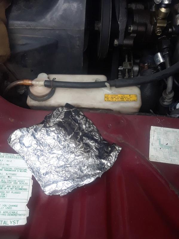

Conductive metal, such as foil turns out to not be such a great idea as a shield. I was inspecting the area and started moving the foil a little bit accidentally and it slid onto the + terminal on the alternator and started a little fire I was able to blow out real quick. It looks like it had been connecting a little bit for awhile now based on how much carbon is built up. I replaced it with a thin plastics film.

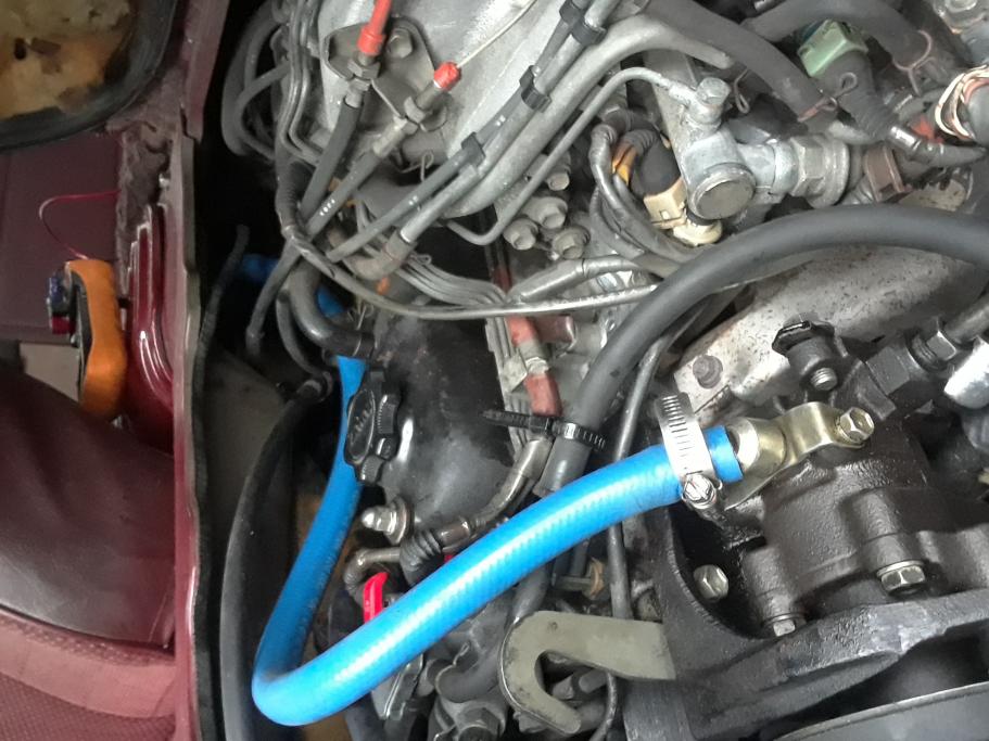

Replaced the hose today, it was a snap. The Parker 5/8" hose fits on snug. Feels like it will last a lifetime.
My question is about the curvature in it, will it matter that its a bit wavy? Should I try and level it out a little bit? I tried to slide the foam off the old one to get it to fit in the bracket but they seemed stuck on. I was thinking about getting a piece of pipe insulation next time i was at home depot.

After running it hot for a while it will settle out a bit. The Parker hose is tough and should hold-up well as-is. Just make sure it's not getting pinched anywhere when you close your compartment lid.
Andy, 1/2" hose is too small. FYI, we're talking about the big suction hose that goes from the reservoir to the pump (pictured above). Tim
