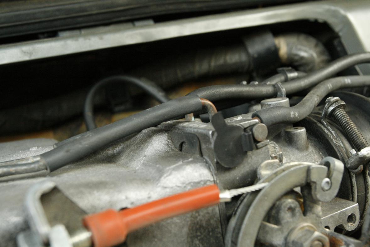

Checked my water temperature sensor. It tests fine. Have not gotten around to checking my TPS (given its unknown age perhaps I should just replace it). However, today I noticed that I can see the gasket between the throttle body and intake is actually visible! Could this be what is causing my cold engine idle problem?
Attachment 744
After a very long ordeal, I SOLVED mine. the intake plenum gasket, the one between the top and bottom of the entire manifold., was leaking. When engine heats up, stops leaking. I did the senor thing, the tps, and much much more until I tore the ole gal down, and saw some gasket missing.... and then it made sense, once while troubleshooting and fiddlin with stuff, running really bad, i had a misfire and saw a puff of smoke come from the area, and i thought, wtf..... should have paid more attention and got right to it., but skipped over it to my ignorance....
