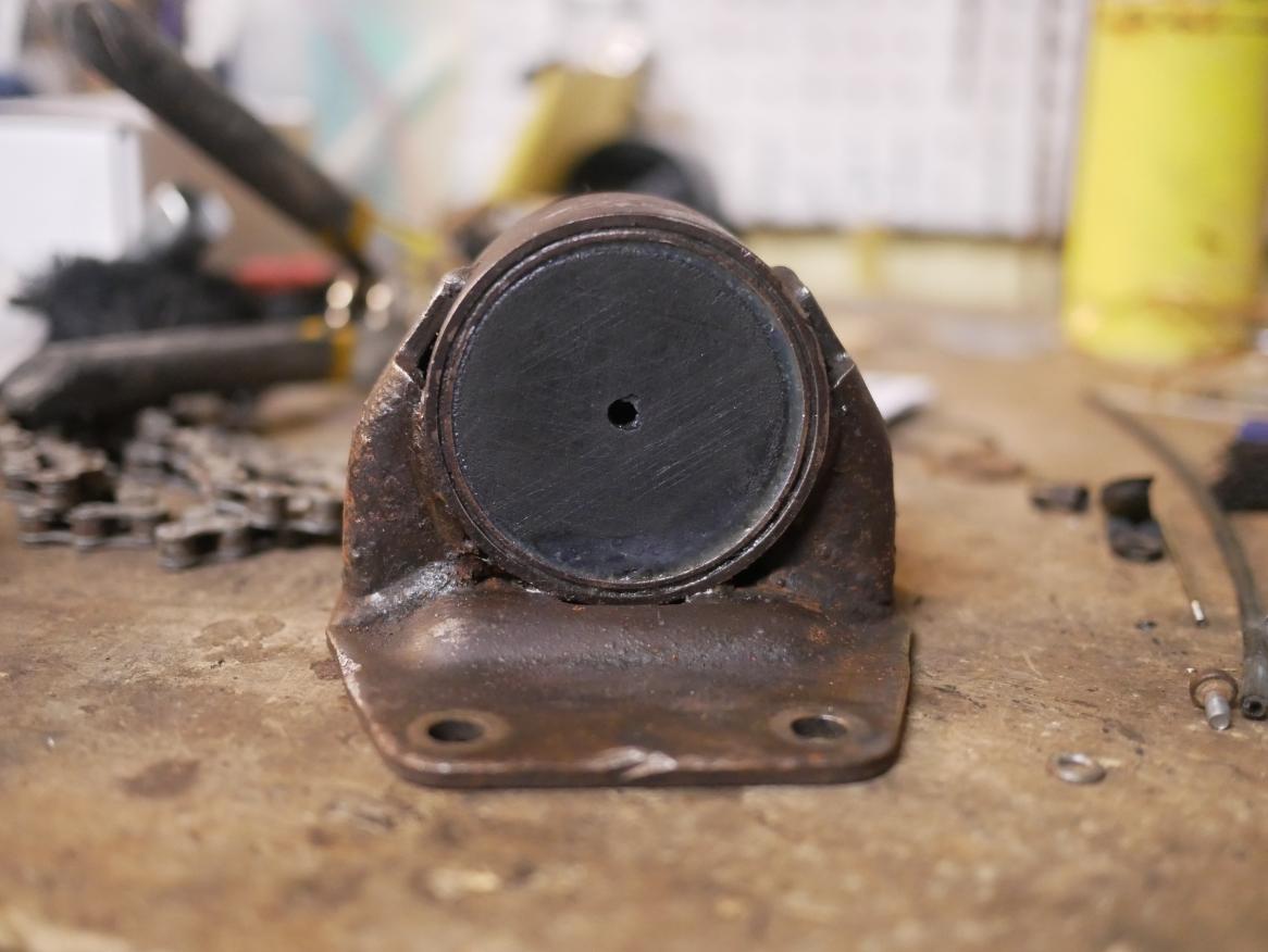

Re: Anyone See This Type of Transmission Mount?
I've also been hunting for a replacement. I wound up visiting my local rubber company and had them fit a new piece of rubber to the old mount. Next, I'll drill out the rubber, fit the metal sleeve for the bolt on the inside, and hopefully be good to go.
I'm considering putting a few more holes in around the central bolt hole to provide a bit more give, almost like creating spokes.
Attachment 7627
