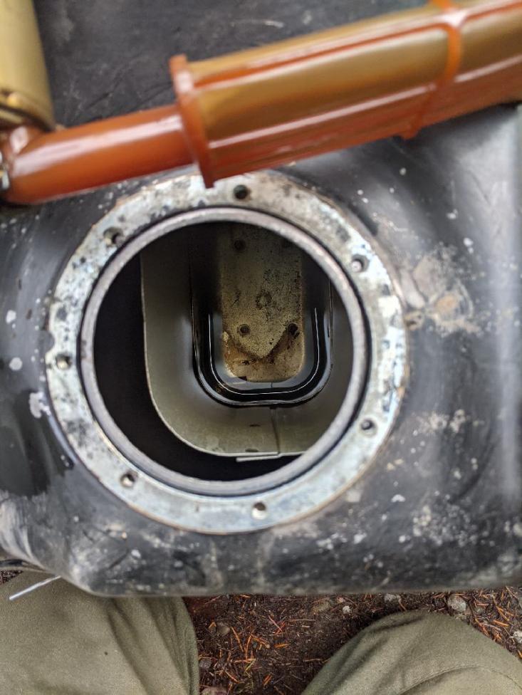

Yes, it was the fuel pump. It hummed for a second or two when I jumped the connector, I pulled the jumper and fired right up after that.
I wanted to note though that I should have tested for power at the pumps 2 prong plug just above the drive shaft before i dropped the tank. If it wasnt the pump it would have been all in vain.

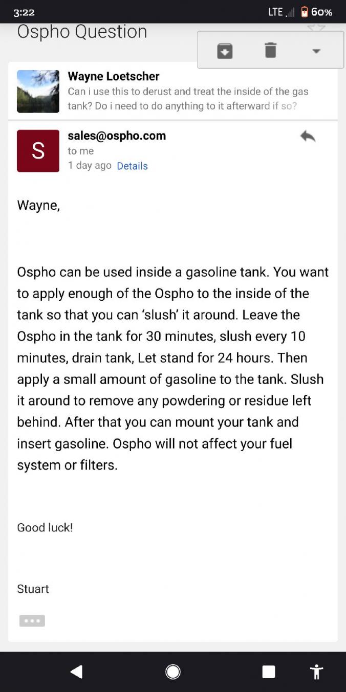

Tank looked fine. A mechanic I talked to said if the outside looks fine the inside is usually fine...but there are some tank restore systems that work. I just replaced the rotting hoses amd clamps. he suggested brake cleaner thru the hard lines but that would have been teedious.
Attachment 11283
Ospho suggested their product would have worked fine though...
