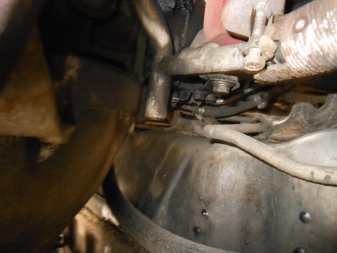

There's a block drain right behind the alternator. It's a major PITA to get too, but if you can open that, between it and your radiator petcock it will pretty much drain the entire system. the block drain is a brass plug with a 14mm hex head. I'm sure you'll have fun with it (I always do) :wnk:. Tim
hint: use a 6 point socket. It's hard to get on it straight and 12 point sockets will tear it up.
Man I never figured this was going to be such a hassle! I am not finding either drainage point from either stated above. I look behind the alternator for any drainage and I don't really see anything. Behind the alternator is a mount of some sort. I can't find the "radiator petcock" either. How bout a hint on the radiator petcock? I would assume I can get to it without taking a bash plate off right? I would also assume it's on the bottom of the radiator? I can provide pics if needed to show you what I'm looking at.
This can't be one of these drains could it?
Attachment 631
Lol, I told you it was a PITA. Here's some pics for you. Tim
http://i8.photobucket.com/albums/a23...e/IMG_1849.jpg
http://i8.photobucket.com/albums/a23...m/IMG_1851.jpg
Thanks Tim. Sorry to be such a pain!

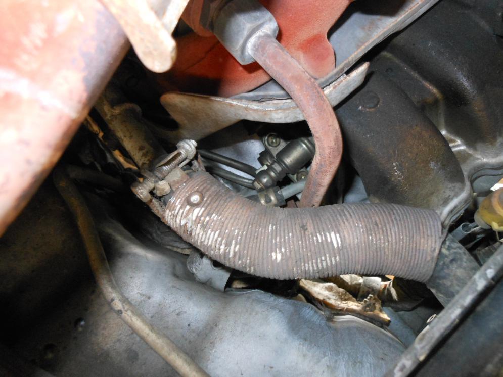

You mentioned antifreeze around the rear of the engine, by the transmission. That sounds like a "hose-of-death" symptom (my '87 had little drops of antifreeze hanging off the bell housing, when looking underneath the engine/tranny).
My '87 had the hose-of-death problem, and would suck the overflow (or, in the case of the leaking hose-of-death, the supplemental :)) tank dry. My '88 had bad compression in one of the cylinders, so I took the head off and had it surfaced and valves ground. I haven't completed putting it back together, but assuming that that fixes the problem, and it was a blown head gasket, that presented some of your symptoms, such as: when I topped off the antifreeze it would blow warm air out of the heater and eventually (50 - 150 miles down the road, depending on how hard I was pushing it) blow cold air and the temp guage would start rising. This left the overflow tank full (even additional antifreeze in it, if I remember).
Now, it's possible that you have a combination of bad hoses. You could have a blown hose-of-death and a vacuum leak between the overflow tank and filler neck. That would explain the reserve in the tank. It might be worth doing a compression test and ensure that your cylinders are within 10% of each other. You can get a compression tester for about $20 - $30.
I thought it might be worth adding the hose-of-death thread link to the discussion, just in case that does end up being the problem. http://www.toyotavantech.com/forum/s...ght=hose+death .
I can only take credit for looking up the link. Tim's pictures were very helpful in cutting an access hatch. I didn't end up with quite the re-assembly quality, as I just cut a "flap" and bent it out of the way and then bent it back in place when I was done. I used the "layout" picture to figure out where it was safe to cut. I cut top, bottom and passenger side of the hole, bent it out of the way, reached in and verified where the vacuum line was.

My hose of death is actually in fairly good shape, as of last week.
Attachment 639
I do plan on cutting the hole to be able to deal with it. Maybe I'll go ahead and deal with it BEFORE I have to deal with it.
