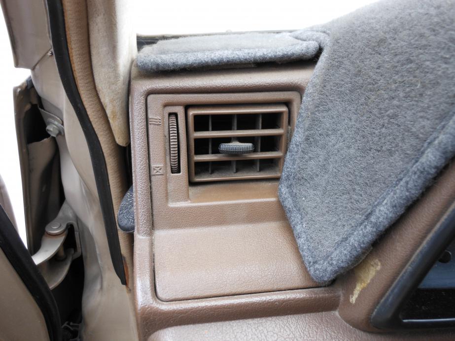

I was hoping I would have gotten a response regarding what exactly is the vents on these vans. I'm really not kidding that I don't know where the vent, or "fresh air" is suppose to be coming from. I always drove before on the freeway with windows up and vents open. If I was getting a little too warm on my journey, I'd turn on the fan. Never the AC.
So am I to rearrange my habits? I really don't want to be working on my AC at this time. I got a feeling that the only "fresh air" to be had is an open window. Or is the "fresh air" from the console settings? The only "vents" I could find is one of these on each end of the dash.
Attachment 680

User1, sorry for the late response, but up until your last post I didn't completely understand what you were asking. There are the two vents on each end of the dash and the double one in the center of the dash. There is also one down by your feet and the defrost at the base of the windshield. The bottom left slider controls whether the air is recirculated or brought in fresh. Fresh vented air kind of sucks on the van as the inlet is small and it doesn't get the "ram air" effect. Intake air must also pass through the fan motor squirrel cage before entering the cabin. The outside air intake is behind the passenger side headlight and doesn't really move too good unless you turn on the fan. Even then it's pretty lame. This is one of the reasons why I'll never give up my AC..........at least not without a fight. Tim
