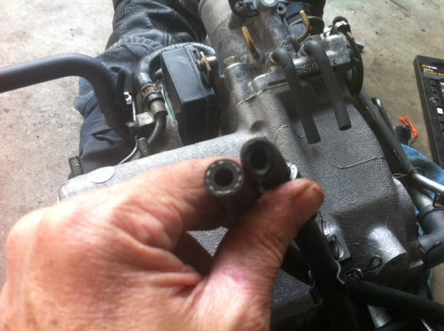

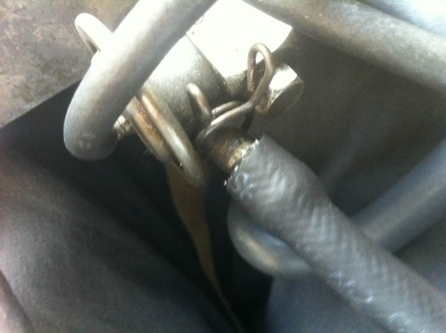

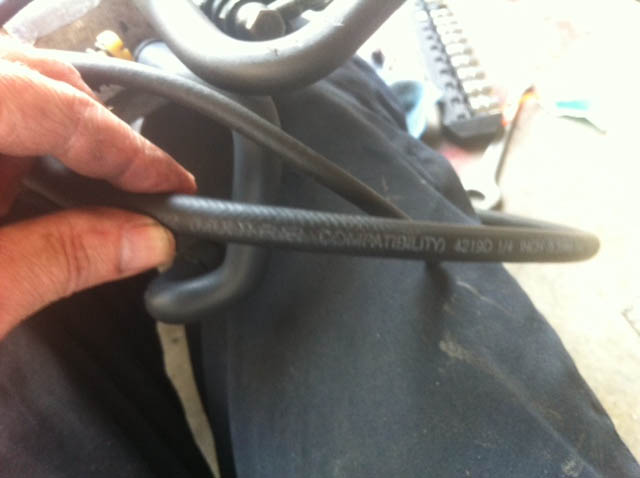

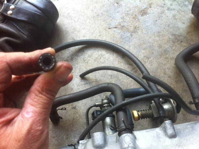

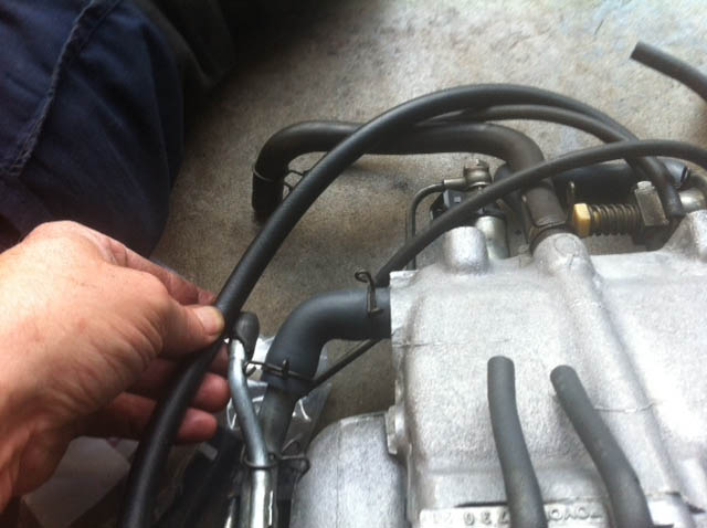

I got the first batch of hoses in and started putting them on my manifold. The Toyota hoses go on in a snap as someone said but the first bulk hose I have tried is a real bugger. I took in a piece of hose to the auto parts store and this is what they sold me. Could someone take a look at the photos and tell me if I am trying to put the wrong hose on here.
It was the closest size they had and the guy said it was what I wanted. It says "multi fuel compatible" does that mean it is OK. I have some hose here from a motorcycle project that says "not for fuel injection." I am wondering if I need some kind of special line or something?
The photos show the hose, where it goes, (by the way the piece looks long because I have not trimmed it yet), a comparison of old and new where you can see the hole size. I realize the bulk hose is harder to get on but this was almost ridiculous. The shot where the hose is finally on took some lube (rubber conditioner... Meguires) and about 20 minutes of sweat and it still isn't on there good. Am I just a weakling?

If the hose doesn't fit easily then I'd look for a different piece of hose. You may have to go to another parts store to find it. The one in your picture doesn't need to be rated for fuel injection as it's just a vacuum line. Tim
Re: Replacing Fuel Injector(s)
Thanks Tim. That was what I was wondering but it seemed to big to be just a vacuum. I will check another store.

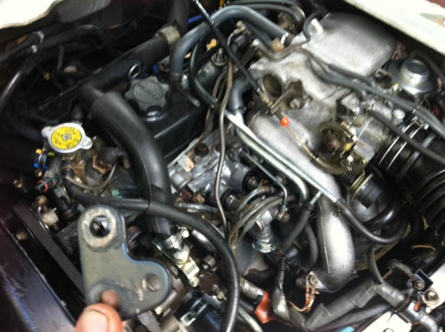

I thought today I was going be riding into the sunset on this project but not so much. I think I have everything back right. Almost. It seems I have an extra part. Maybe someone can draw a line to where it goes in this picture.
http://www.toyotavantech.com/forum/a...2&d=1339982183
I was a little apprehensive to try to start it because I couldn't remember where this part went and also because I was the mechanic but I tried and it runs!!! :rol: I only ran it for a few seconds but it seemed to purrrrrr for those seconds.

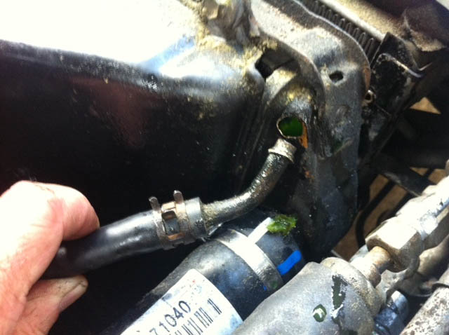

The thing that kept me from driving it thought was this. As I was putting the coolant in I heard a trickle and found this. I remembered when I put the hose on the radiator felt a little soft. Am I looking at a new radiator or can I get this repaired successfully? :pissed: Shoot!

That little piece is a support bracket. It goes between the upper and lower intake manifolds and also provides a mount for the cold start injector line. It would probably be okay without it but there's a small chance of stressing something due to vibrations (over time) if it's not there. You are lucky it's the front bracket and not the rear one. It should be easy to put on..........Here's a picture showing the correct location.

That's a bummer about the radiator. Looks like it will need to come back out again. Just take the radiator and the broken nipple down to a radiator shop and they should be able to repair that for you. I'd probably have them remove a tank and inspect/rod it out while it's there. I'm guessing the repair, inspection, rodding out, will cost around $100 - $150. I'd ask them to beef it up a bit in this area so it doesn't happen again. Tim

Perfect! Now my memory is coming back. Glad it is in the front!

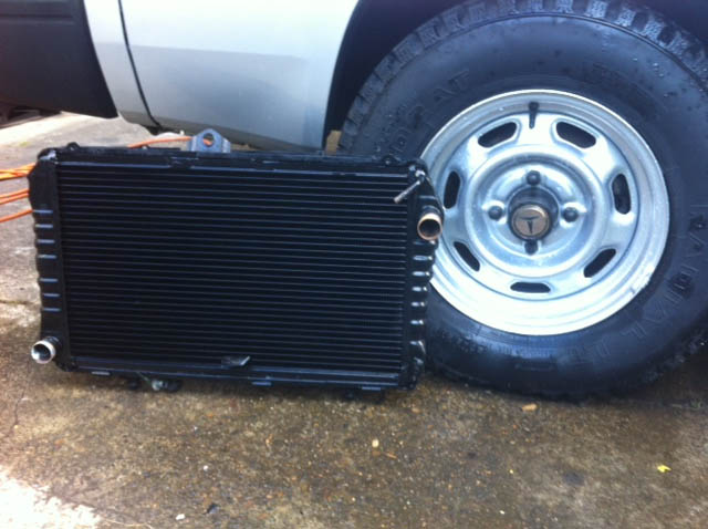

Thanks for the feedback. I just removed the radiator and it feels so frail! the top strip of metal came off one side and one 1/4 row of those little squiggely things is lifting off the same side. It doesn't look good to me. I will take it to the radiator shop and see what happens.

I got my radiator back from the shop. It turned out it was pretty bad so I ended up replacing the core. The new core + the maintenance ran me 245.00. Here is a shot of it posing next to my freshly painted wheels.

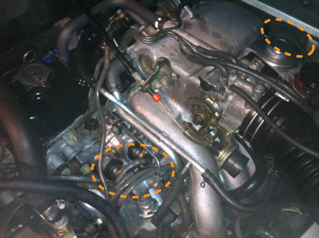

After I got the radiator in and put in the fluids I started it up. It fires right up and then seems to struggle. It sounded way better before I stated this project. I must have a vacuum hose out of place or worse. At least it doesn't smell like it is ready to go up in flames. I probably jumped the gun putting the seats back in. I am guessing I probably should have adjusted the timing and at least checked the plugs.

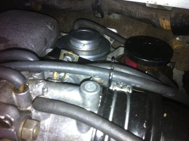

One thing that kind of worries me is that I got the #1 and #3 injector wires crossed (the first two you can see). I never marked the wires (!!) and I think I assumed the wire that best reached would be the right one but I think there is a chance I did this. Would the engine run at all if I did? I can still get to those first two connections if someone thinks that is a possibility.
The other things that are circled are confusing me also could someone tell me what these round things do? I don't think I have the hoses right do I?
The bigger of the two has a hose from the bottom that is short and connects directly below it correct? I couldn't find a diagram to help me here.

Could I have damaged the smaller plastic one by cleaning it. Speaking of the alternator and/or some of the bits by the fan in the front of the engine seem nosier since I did this work. Could it be because I cleaned it (SuperClean)? Maybe all the grease was good for it.

I could see maybe getting the wires for injectors 1 & 2 reversed, but it would be pretty hard to get any of the others mixed up. I can't imagine getting 1 & 3 mixed up. The length of wires on the harness would make that very difficult.
Those 2 round things in the back of the engine are your EGR valve & EGR modulator. From what I can see in the picture they look to be hooked up correctly. The modulator (plastic one) also has a hose on the bottom (can't see it in the picture). Make sure that one is hooked up.
