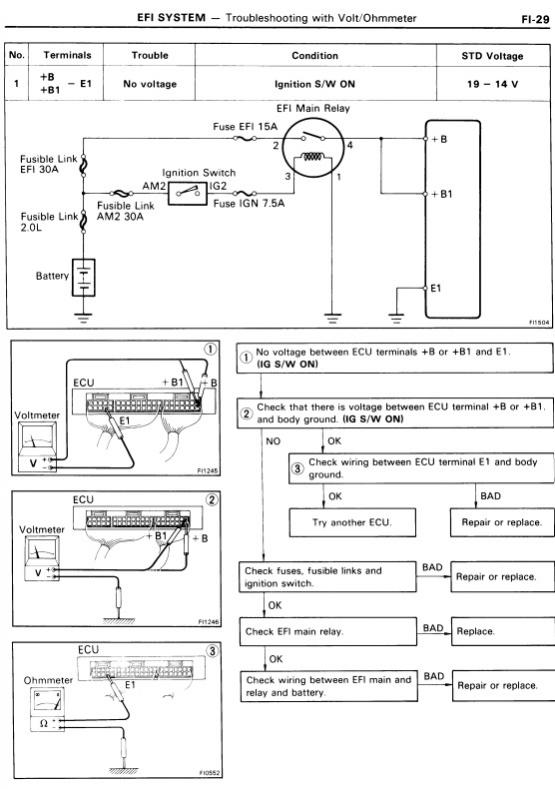

According to the wiring diagram, the cold start injector doesn't go through the ECU so that would explain why it is firing and not the main injectors. Here's the link again to the section from the factory service manual for the fuel/ECU system:Attachment 11877
Here are the relevant pages for testing the ECU terminals:Attachment 11878Attachment 11879Attachment 11880
A quick check would be to check that the 15A EFI fuse isn't blown and the ECU is actually getting voltage.

Status
When key is in run position
The ECU is getting the proper 12V power supply. As it should be.
At the FI1 and FI2 plugs I am measuring 12V on both pins. As it should be.
But with the either FI1 and FI2 plug out I am seeing 35ohms unplugged between +B plug and ignition. So I think I have leakage path there. Not sure this is enough to keep the ECU from pulling down the 12V and fire the FIs.

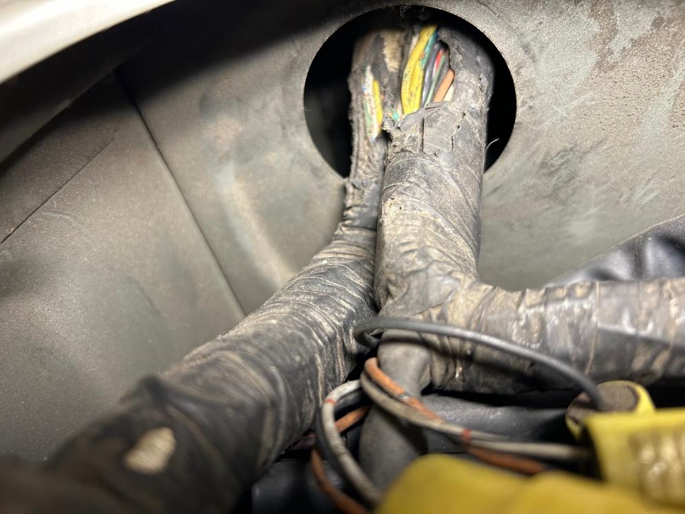

Finally figured it out.
After going through the TSM troubleshooting and doing the last ditch "try another ECU". There was still no change. I knew there was still no signal to the FI from the ECU but not sure why. All the inputs the TSM listed were there. But after thinking about it and the troubleshooting there wasn't any mention of testing the signal from the distributor/ignitor to the ECU. We saw an ING and IGT signal but there was a white wire coming off the ignitor called Ne. So chased that and saw the wire was not ohming out. Dig out the bundle and saw the problem immediately. The bundle passed through a sheet metal hole and the protective cover came off and the wires had been slowly cut the white Ne wire. Patched that break up and turned the key and it fire up fine and is running great now. So, this single wire that wasn't really covered in the TSM can be a source of no FI signal. I had to look up the Ne wire purpose on another Toyota site but sure enough it input the signal that was the FI. https://www.toyotaguru.us/engine-control-systems/input-signals-required-to-pulse-
Anyways van is running strong now. Thanks for help and hope this helps someone else out there.
