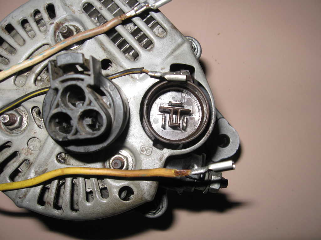

melted alternator plug, anyone got an extra on they could snip?
okay so this looks like the fault of accumulated psf. thought I had fixed the leak with a new hose but i guess there was still a small drip.
anyone got one of these they could sell me or any crafty ideas.
Thanks, Niko.
http://i1304.photobucket.com/albums/...ps10d47fac.jpg
http://i1304.photobucket.com/albums/...ps14d7aa16.jpg
Re: melted alternator plug, anyone got an extra on they could snip?
The harness for the van has been discontinued, but there are lots and lots of similar harnesses on other models in the salvage yards. You could chop that end off of one then solder/shrink tube it to your existing harness. For an emergency repair you could do what I did (below). The spades inside the alternator are standard so you can make each connection individually (just don't mix them up). Tim

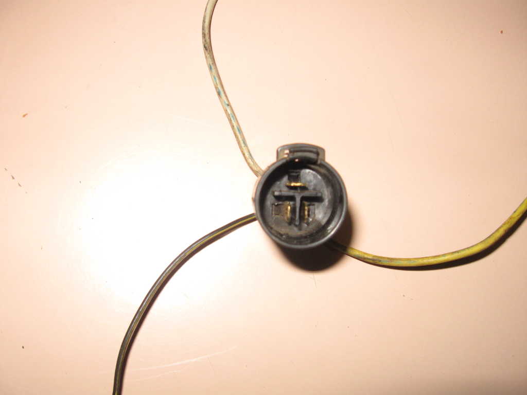

Can you folks tell me which color wire goes to which blade of the alternator end of the harness? When I pulled my alternator out, the wires came out of the corroded plastic plug.
Attachment 1599
This is the other end of the harness:
Attachment 1598
I don't mind duplicating the "hack job" Tim showed in an old thread, or more likely just embedding the connectors into the plug shell in the right places and cementing them in with RTV or Plast-Aid, but I don't know how to tell what goes where.
John
Re: Christmas lights continued
Great! This is exactly what I needed; thanks, Tim.

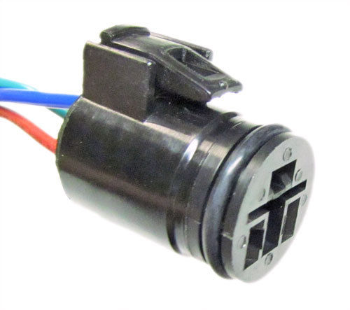

I don't think I'll monkey around with trying to fix the old harness connector shell; a new replacement on eBay is only $11.25:
http://www.ebay.com/itm/151303054390?item=151303054390
Attachment 1600
