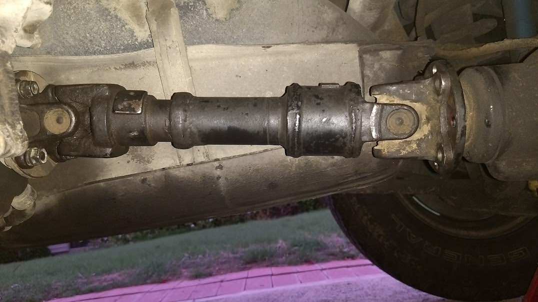

OK, I have what I believe isa new option for for those with non-replaceable U-Joints, Especially for those with 4WD (which I would presume has a shorter DS than the 2WD...
Warning, this may not work for 2WD OR if you get lucky, it may be a bolt in!
So this is 4WD rear shaft only on the 87 and up 4WD vans:
Background:
I also have 4 Samurais, (one parts rig) and the later, Post 88 Samurais happen to have the same drive flange bolt pattern as the 4WD Toyota vans, as well as the same size alignment rim for minimizing runout.
That's good! However as short as the Samurai is, the rear DS is still longer than the 4WD Tvan DS. 5 inches longer. My parts rig is an 89.

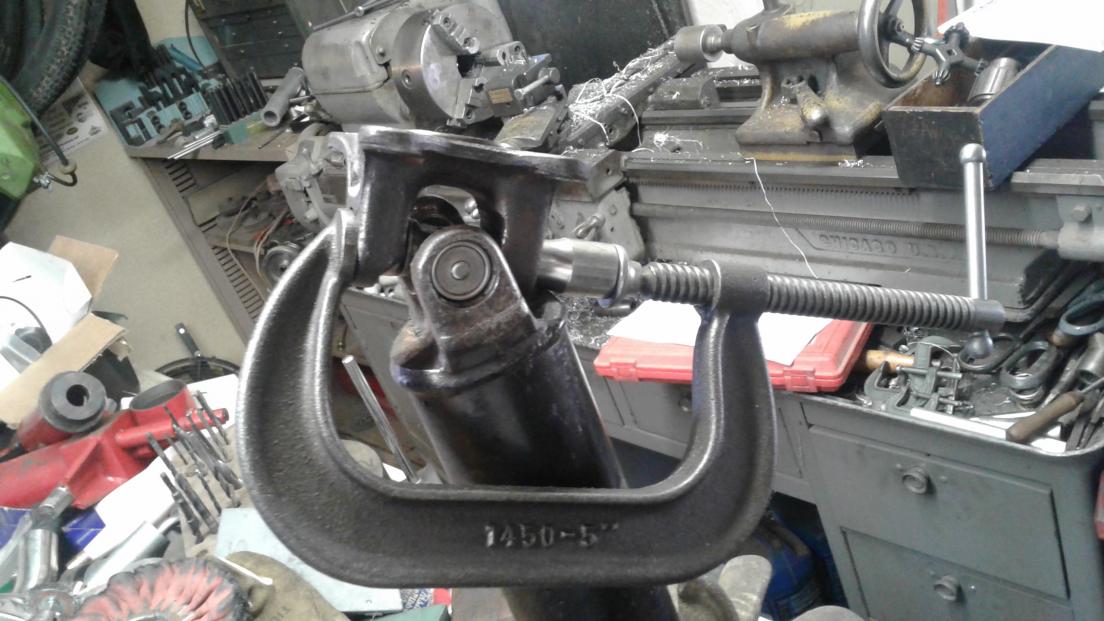

This next part I have done many times to make a custom length DS over the years:
So I cut the weld and broke the yoke off the tube, (making sure it was clean and the shoulder was square (lathe work...)
Then I used a tubing cutter to shorten the tube for an effective 5" total shortening of the completed DS.

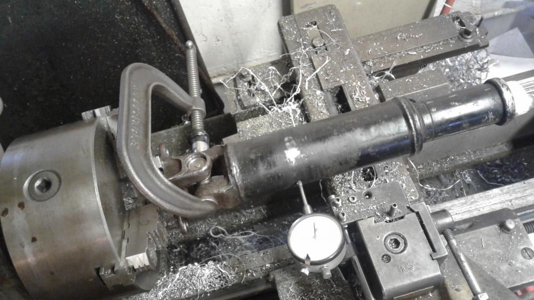

I deburred the tube (Half round file) aligned the yoke after pressing it on, (I used two arrow shafts wired against the side of the U joint holes and used those to sight the arrow shafts parallel).
I used a pipe clamp to ensure the shoulder stayed solid on the tube end.

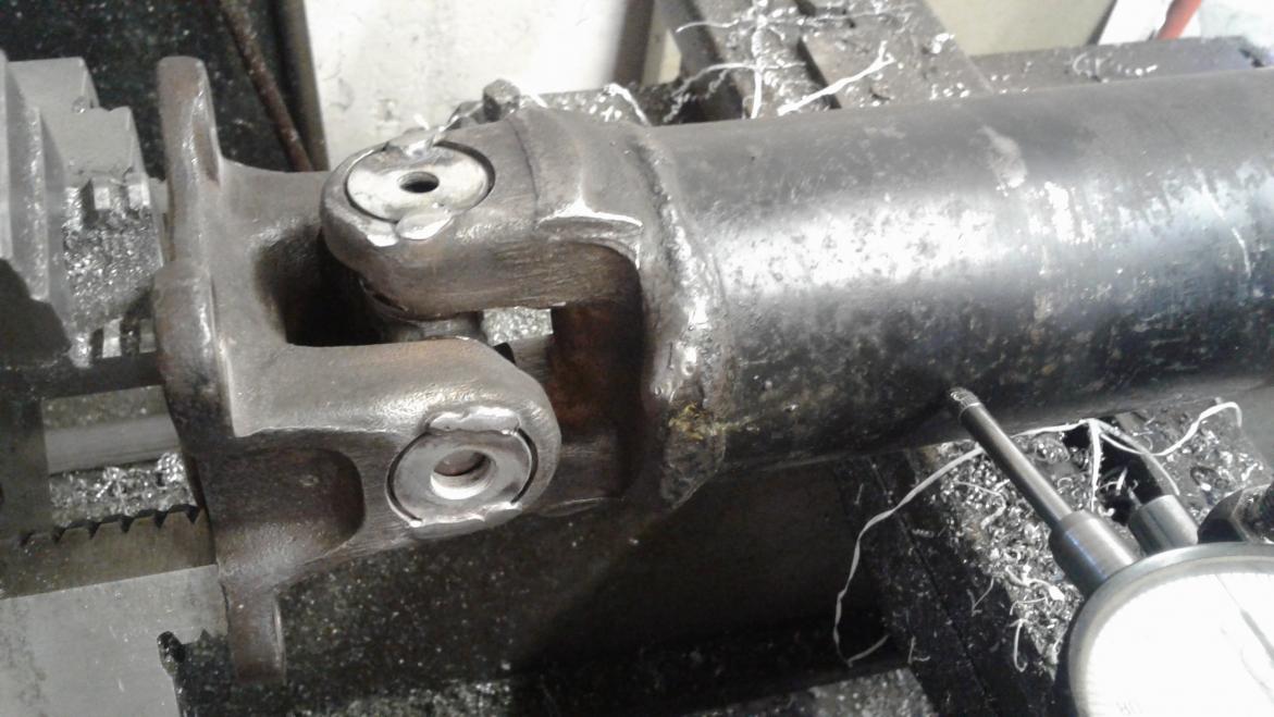

After preheating (the yoke has more mass that the tube so I concentrate the heat there to eliminate "cold welds" ) I tack welded the tube to the yoke, in three places, then welded it up.
I rechecked the alignment and proceeded to installing new reasonable U-joints.
NOTE: I ALWAYS repack the new U-joints with Mobile 1 synthetic grease; (The factory grease is only useful for keeping the bearings from rusting, if that. get that crap out of there...)

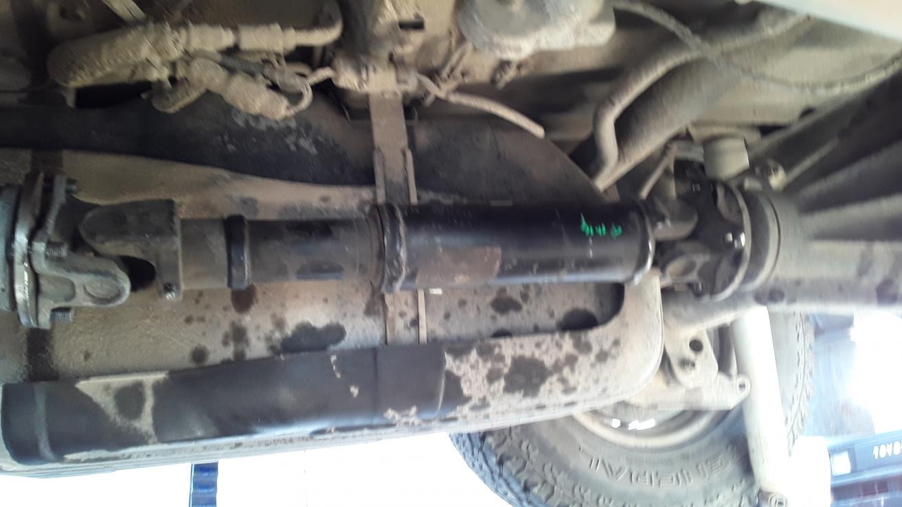

The welded yoke went right together easily. The other end had one tight side and I needed to clean the hole up. Don't force a cup as its hardened and can raise a ridge in the softer yoke which has to be removed... (best for this is a reamer, This happened to me here and I used a dremel sanding cylinder since I lacked the reamer)
After than it was a simple reinstall to replace the DOA factory DS. (lasted 315K miles so decent life..)
So this can be done in the home shop if you have the equipment. If not, visit a local DS shop that can do custom work and get a quote for shorting a DS.
Samurai DS come up regularly on Eprey or even C-list. Assuming the DS prices are not silly money for a simple shortening job, this HAS to be cheaper than the custom new DS.
The KEY here is to get the 88-1/2 or later Drive shaft (the rear one, the front is longer, so that may be a possibility for the 2WD model T vans if longer than the rear.

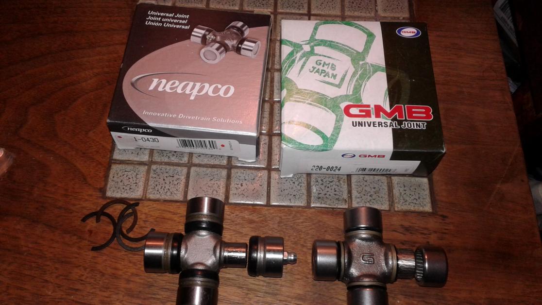

so heres the GMB $7 rockauto u joint and a Neapco $27 delivered from ebay u joint with inner clips and grease fitting. the neapco pic on ebay was stamped made in usa, the box this u joint came in said made in china. im curious as to the rockford u joint and its country of origin and the size of the 'inner race'. the gmb is a beefy .625" or so...the neapco is .524" or so...i imagine because the cups are machined and have the clip grooves in them. i have machine tools and could cut outside clip grooves for the gmb but it would be a pain...ive also seen people stack washers on the outside of the cups and tack weld them to keep the cups in place....anyway..i guess i have too much time on my hands.
So Boogieman, I see you went with the GMB branded u joints and stacked some washers and welded. Any issues with balancing? How are they holding up thus far? Happy with them?
I am going to go the same route and was looking for feedback. :)

ive got close to 20k on them with no issues...a fair bit of that offroad, i never had it balance checked but no vibrations of any kind...it would be nice to figure a zerk fitting out, it may be possible to tap that ujoint but its been a little while since i had it in hand...also maybe having the yoke machined for a clip or screw retainer would be cool....

definitely pack the bearings i think theyre shipped with just enough grease to prevent corrosion, and i was concious of cooling the welds after each small bead as to not cook the grease...
