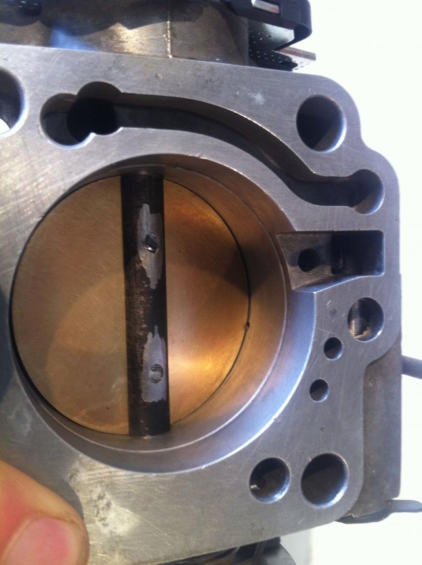

I am having a mixed experience attempting the Throttle Body cleaning. My main issue is a lack of ability to follow directions. When I disassembled the throttle body, I did not scratch the original orientation of the disk. It did not seem like a big issue, the 'engine side' had the most crud build up and I could still see its traces after the solvent dip. Given that I had some confidence in which side was which, It only seems to 'seat' in one orientation. But just to check, I tried the other side, and it also seemed to work in one orientation. The catch, is that neither orientation passes the 'light test'. Its tight but not air tight. If I did not have timrv's great write up, I would assume the disc was symmetrical, one side is the exact opposite of the other side and the bore is completely symmetrical. The disk would have two possible orientations. But, it's more likely I'm doing it wrong.
So, sorry to ask a question already answered in the thread, but, does the disk always pass the light test perfectly? I've spun it around and around without getting a perfect seal.
I'm attaching a photo of the disk, I have the throttle very slightly open, you can just see one of the ports, in the bore, starting to show. Maybe my orientation in completely off. Does that look right?

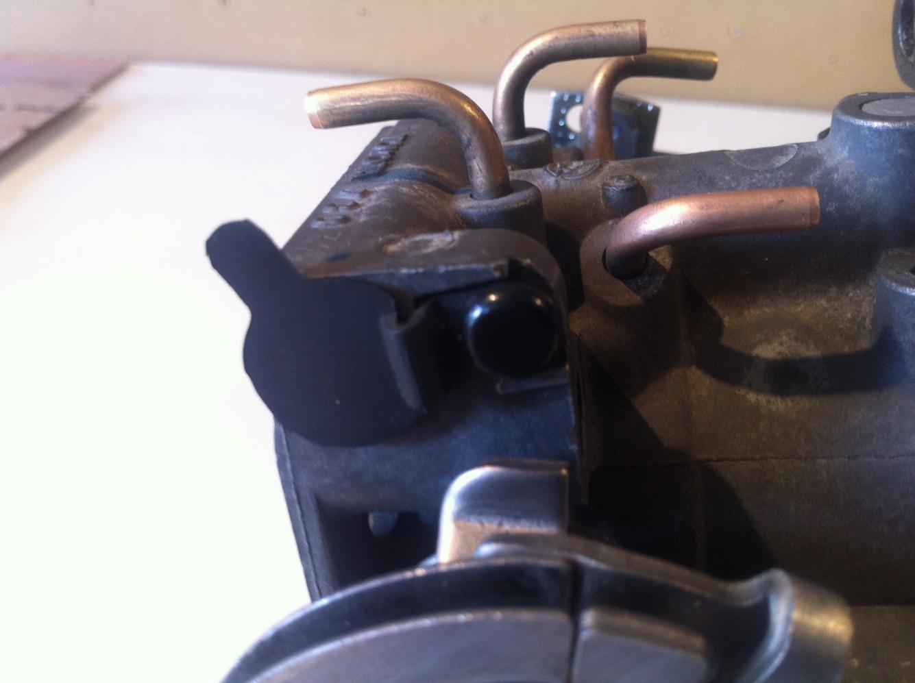

The next failure to interpret directions well, involved the rubber cover for the idle adjust screw. I looked at the two ground 'flats' that timrv put on the metal stud and thought they were there so he could get a wrench on it, not so he could just pop the rubber past the tight spots. I yanked out the stud and its not very pretty after my abuse. I had to replace it with a plastic male/female part that I pulled out of a random part drawer at the local hardware store. I will see if it can handle the heat.
Don't yank out the stud holding the rubber cover.

After installing and lubing the shaft seals, the very next step is installing the shaft, disc, and seating to the correct orientation (before any other assembling). Once you put the cable guide on the throttle shaft the "throttle stop screw" will interfere and prevent complete closing of the disc. Don't mess with the throttle stop screw as it's set at the factory and should never need to be adjusted.
Take the cable guides and springs back off and do the disc alignment over again. If you've already installed the TPS, I'd advise taking that back off just so you can have full control over throttle shaft while setting/adjusting. Tim
BTW, you could be right about the disc being symmetrical (at least when flipped 180 deg). Whatever way works I guess is good enough. There's always springs and things you could add later if the throttle doesn't want to close all the way :dizzy: . I can be a bit anal I guess. I'm set in my ways and tend to be so unyielding that others will sometimes ridicule me for it. It's my personal choice to try & put things back exactly as before as to reduce my chance of potential problems. Tim

One positive is that my throttle does close all the way. In the photo I was holding it open, trying to establish a reference point. Its hard to describe how the disk is set in the body, so I just opened it a hair, and you can just see a port exposed. I'm hoping thats normal.
The disk sits tight in the body in two orientations. With out the back light, it looks tight. But if you hold it up to a light, you can see light around the edges. When you hold up the assembled body to the light, is there NO light filtering through on the edges? I could not get it that tight.
I flipped it a bunch and never got a completely 'dark' fit (NO light at edge). I was fitting it before any of the other assembly, with the two screws loose. Do you think it might still work?

Once again, I score low marks in reading comprehension.
I just re-read Tim's response to my original question. I think that my disk is set tight in the body. Once its assembled, the 'Throttle Stop Screw' is holding it slightly open. I was confused because I thought it was tight but after assembly, its barely gapped.
Thank you again Tim for your answer. The Throttle Stop Screw was not on my radar even though its right there. I think my Throttle body is ready for service, I hope thats not just wishful thinking.
