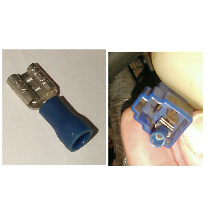

This is a simple switch so positive and negtive are irrelevant. You can crimp an insulated female spade to each wire on the van and plug one into each terminal of the float connector.
Printable View

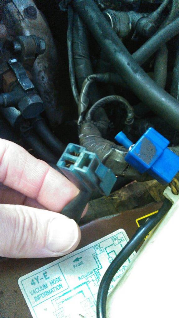

It's just a switch. 2 wires coming from van harness hook to the 2 wires coming from switch. No particular order necessary. Rather than hack your $100 switch, I'd probably put some female spade connectors on the van harness (where those butt connectors are) and plug those into the new float switch harness. Tim
One simple thing would be to put female spade connectors on the ends of the wires on the harness, and plug them on to the male spades in the connector shell. You might want to tape around the outside of the metal part so there's no chance the connectors will touch.
Attachment 3791
This is what should be on the harness, which can be bought here: http://www.clipsandfasteners.com/Met.../w38c005-5.htm
Attachment 3792
Update... I missed the two response before mine (they snuck on to the next page, that's my story and I'm sticking to it). Sorry for the redundancy.
Oops, that link is for the female shell, but the one on the harness is the male side:
http://www.clipsandfasteners.com/Met.../w38c004-5.htm

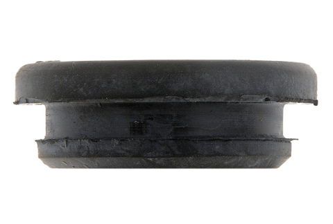

btw: i found another grommet that works well with NO modification. fits the sensor and the reservoir tank nice and tight:
Dorman 42055 PCV Valve Grommet
been in there 3 months no leaks or problems.
be xtra careful inserting sensor into the grommet and then into the reservoir tank (maybe use a little grease or silicone spray) those yellow wires can snap off very easy (ask me how i know) and you'll need to re-solder back together.

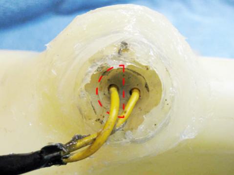

PNW, one of my yellow wires broke off at the base of the tank when i lifted it out of the way to replace my alternator. is it pretty easy to solder? i have a cheap-o soldering iron that I'm very inexperienced with (only used it once or twice) so I'm planning on giving it a go but thought id check with you for any tips to get it done proper.

yep this was my first time soldering as well and i bought the cheapest smallest soldering iron from harbor freight. my situation was additionally challenging as the wire broke off inside the plastic bottom of the sensor. i had to carefully cut a half moon section out of the plastic with an x-acto knife to expose the wire inside. and very carefully get a hot blob of solder on the yellow wire and get it stuck onto the exposed wire inside. it worked! i've checked it a couple times when the engine's hot and cold. i figured what do i have to lose to attempt a repair and if it fails later down the road i'll buy a new part.
just go slow. and don't worry: worst case scenario you have to buy a new sensor.
this isn't my photo of my sensor but here's about how much plastic i cut out to get to the wire:
Attachment 5197
