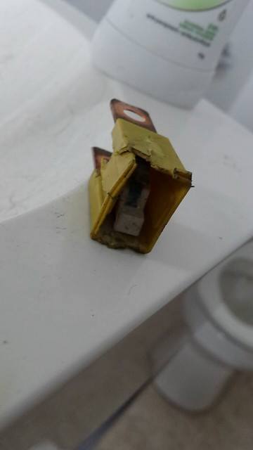

So some recent problems with my 87 4WD van. First the headlights went completely out. After searching, replacing stuff (even swapped out the main fuse block!), testing, etc...found the cause to be a blown Fusible Link behind the power steering reservoir. Replaced that...all is well....for a little bit anyway. Driving to Oly the other night with the headlights on, chillin', cruisin' and all of a sudden everything shuts OFF! Dash lights, head lights, engine...ALL OFF! Traced the problem to my AM1 Fusible Link. The van is killing these things one by one! With no tools or spare fuse, had the van towed home....luckily I wasn't far.
Off to the parts vans I go. Both had the fusible links still. I replace the AM1, van started but when I turned on the headlights, the van wanted to die. After playing with this a few minutes, the van died and blew the headlight AND EFI FL. WHAT?! :cnfsd: After inspecting, I'm finding the van has/had some fairly corroded Fusible Links. I replaced the blown ones with the best ones I had and now turning on the headlights isn't an issue and the van seems ok. I want to keep spare Fusible Links in my vans. Having problems finding them online... are they NLA? Anyone have part numbers for these? I looked at the online FSM and didn't find part numbers. I'd like to have at least 3 sets of each. Picture below of what I'm looking for...any info is appreciated.

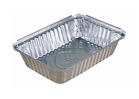

thought i'd pass along some potentially valuable info related to fusible link trouble shooting:
only had this van a few months. it runs and drives great. but i noticed when it was wet and rainy van would start and run rough. a few times (only when it was pouring rain) engine completely lost power and shut off. after it dried out van started up fine and drives fine.
i replaced distributor cap / cap seal, rotor, spark plugs and plug wires.
i also covered the 1.25B fusible link with an aluminum sheath.
no more problems! even when van has sat in the rain for days and driven in pouring wet conditions.
i can't say for sure covering the fusible link in an aluminum sheath was the only fix but it seems like a good idea to help keep off water and dirt etc. some people say a thin coat of dielectric grease on the FL might help.
i used these aluminum take-out boxes 3 for a dollar at the dollar store which i cut and bent to shape. also made a shield over the alternator with same material. maybe i'll make something a little more permanant later.
